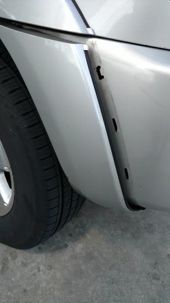

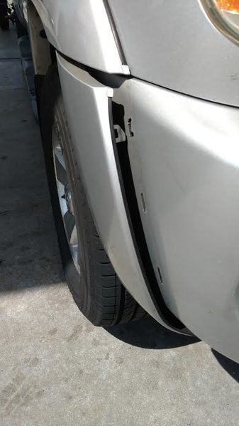

    I drove the Tacoma down to Florida, and when I pull into the resort - this piece of trim on the front passenger fender was hanging.
    Can someone tell me if the tab on top just snaps back on or do I need a clip or something?
    If I need a clip I will probably take the trim piece off so I can get a part when I get home.

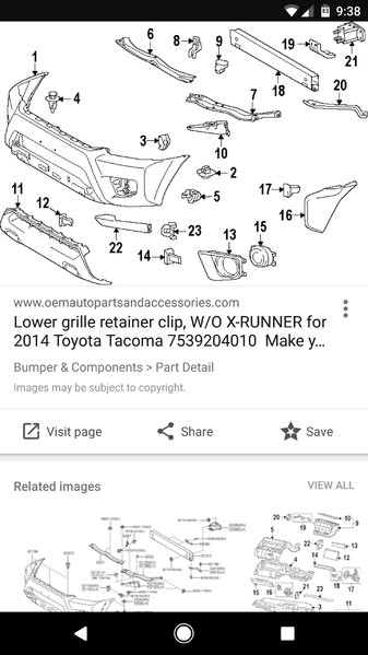

    Those flare extensions have a blue plastic T-clip that locks it down from behind. Looks like the top tab is the only one left... There should be one for each of the slots you see in the fascia

    #17 in the top image

    Thanks - that exactly what I was wondering - I hit something on the road and it popped everything loose - looks like I need to remove the screws and take it off until I can get a clip - but need to be looking for a replacement for this trim.

    Looks like the bottom 2 just broke off.
