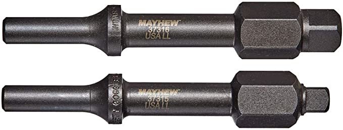

    Since you mentioned that, have you ever used a “Shake n’ Break”
    It goes in an air hammer and you use a wrench with socket on the end.
    I haven’t used you yet, but there have been a few times it would have come in handy.

    I've heard of them, if its to that point its likely already rounding and I have the gas axe lit.
    Those would be ideal for the bed bolts, I havent run into really bad bed bolts yet, but I've seen them with other techs.
