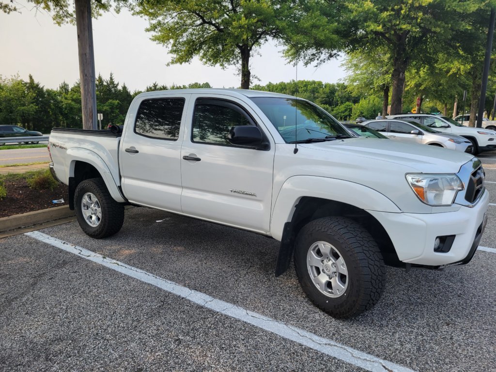

  12. Jun 3, 2025 at 3:17 PM
    #32
    Sonofliberty92
    Sonofliberty92 [OP] T O Y O T A
    Sep 20, 2021
    #377626
    1,066
    Mark
    Maryland 4 South
    2014 DCSB TRD OR, 2005 Tundra V8 4WD
    Got my truck back today. RXTs, 5100s in the rear along with new U bolts. U bolts are hella long though. Im gonna have to use a saw to cut them down or get the mechanic to do it when I put the 5100s up front. This is the current stance. OEM Bilsteins in the front with the factory spacer.I'm going to wait until the leafs settle to add the 5100s up front.
    I actually really dig this. Exactly what I was looking for.

    Texas
    cheap and easy to see if it works

    MSgt O
    MSgt O Well-Known Member
    Nov 4, 2020
    #345824
    1,218
    2013 Tacoma
    wait until you get it all lifted and see what you get for shimmies and vibrations first. Looks good!!
