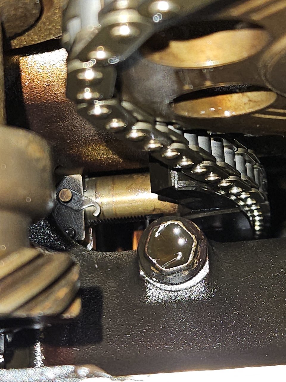

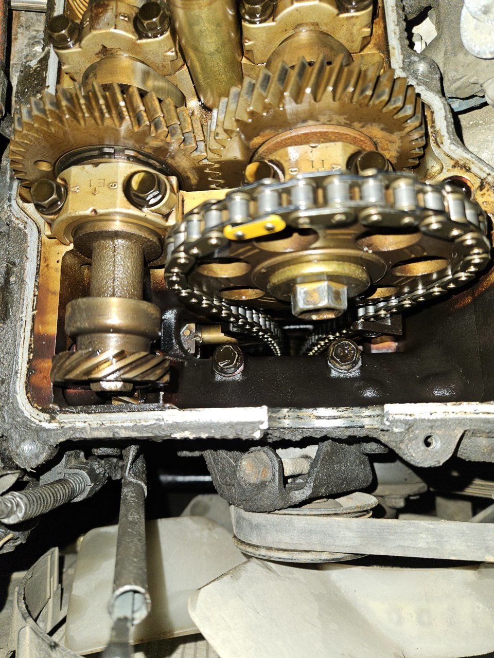

    That chain tensioner sure is far out. You can crank the engine and watch it.
    Heck you can remove it and see if it holds any pressure. They are fairly easy to get at.

    It is far out. And looking at this picture below, the oil stain on the tensioner recently changed.

    Could be those balance shaft chains too
