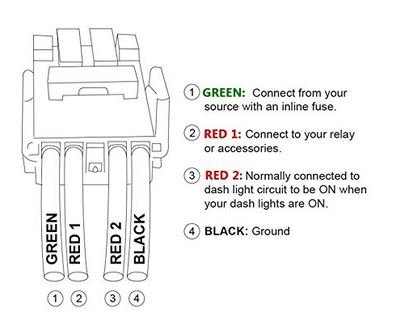

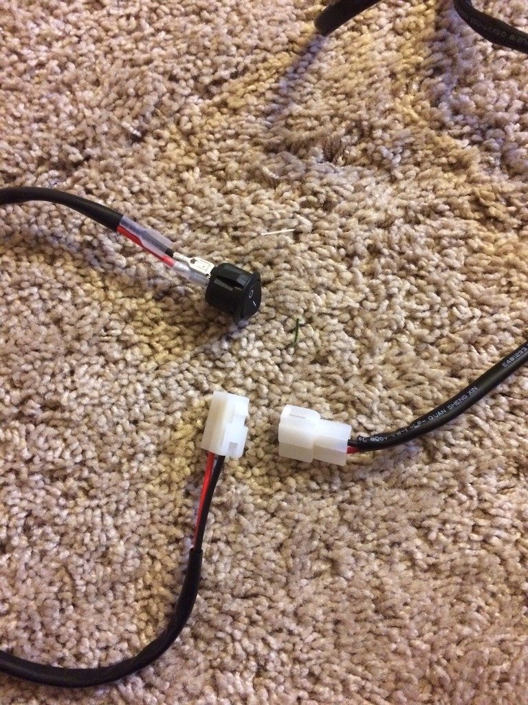

    I am trying to wire what seems to be the same switch but the switch that came with my lights has only 2 wires. How would I wire this switch to my harness?
    Switch that came with my lights
    Wiring diagram of new switch
    Any help would be appreciated.

    1. Power in
    2. Power out
    3. Attach to power from dash light circuit
    4. Ground
    Your 2 wires are power in and power out. I would assume red is power in and black is power out, but it doesn't really matter. If you wire it backwards the switch will work backwards.
