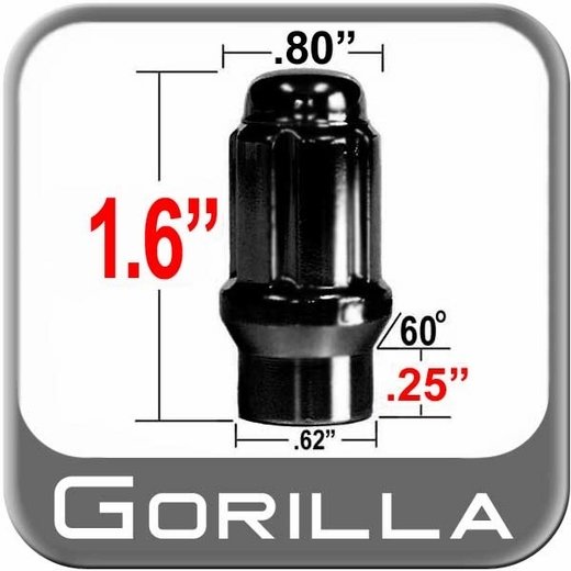

    Hello tacoma owners.
    I'm a noob here. I'm planning to put on some ray10s with 265/70/17 falken wheels along with 1.5 spacers. I know I will need extended lug nuts, but the question is. Which size? 12mm x 1.5?
    Can you help me? The last thing I want is the wheel to fly off while driving.

    12x1.5 is the thread pitch. None of the links you provided will work, you need ET spline lug nuts that look like this. upload_2020-8-5_23-27-11.jpg
    I HIGHLY suggest you buy the lugs from SCS. I have the gorilla brand and I absolutely hate them. They get stuck in the key and the metal is all chewed up.
