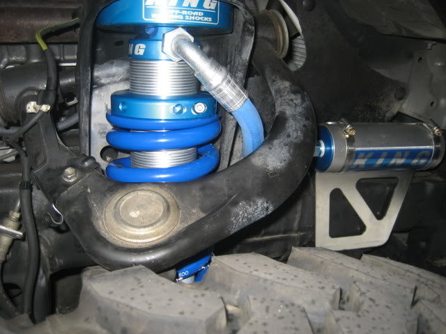

    Yessir! Coils lift the front. With the Fox, Icon and Kings you can completely adjust the lift. As in there is a collar that screws down the shock body to raise/lower your front lift. More you crank them down (more lift), the more pre load you'll have which equals a stiffer ride. Normally they come preset to about 2" of lift.
    Here is a good pic showing the threads. That is a normal amount of preload. Also depends on spring length (King has 14" springs, Fox and Icon have 13" springs, so you'll see more preload on Fox and Icons than Kings).
    Also you will need new upper control arms, I highly recommend total chaos. Best made in my opinion.
