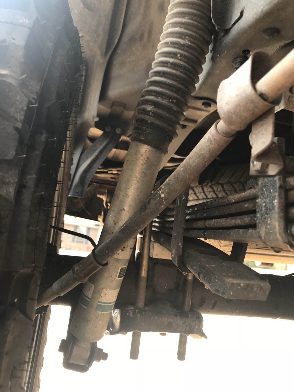

    BUMP lol I literally explained your problem @Tacocam24
    I'm confused why you're looking at longer shocks, just pull the block, you have both an AAL and a block, that's why you have a huge forward rake.

    Get rid of the block and go 1" AAL . Bilstein 5125s shocks for rear .

    HE HAS BOTH :anonymous: drop the block and you'll be golden

    I've literally been saying that since earlier today lol there's no reason for him to go with longer shocks, he has a great setup already, just needs to get rid of the block

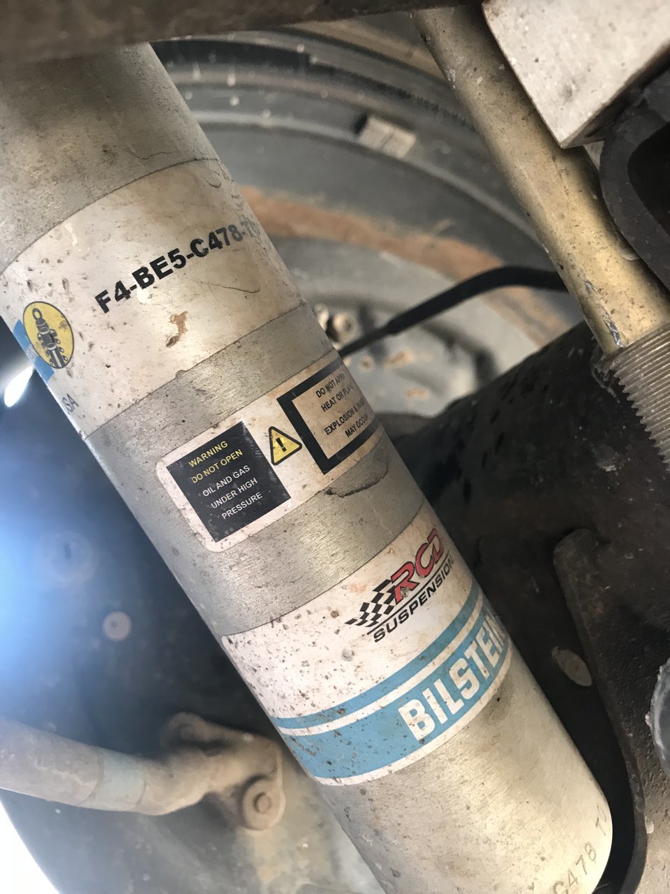

    You shouldn't need longer brake lines with the standard length 5100's. But if you want to be sure you can always let the shock fully extended and make sure that the lines are not taught. IF you were to have the B110's which are the extended RCD Bilstein 5100's then longer brake lines would be needed.
