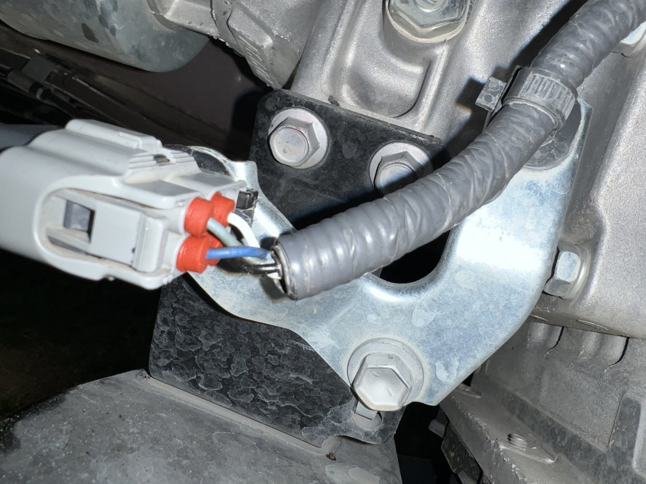

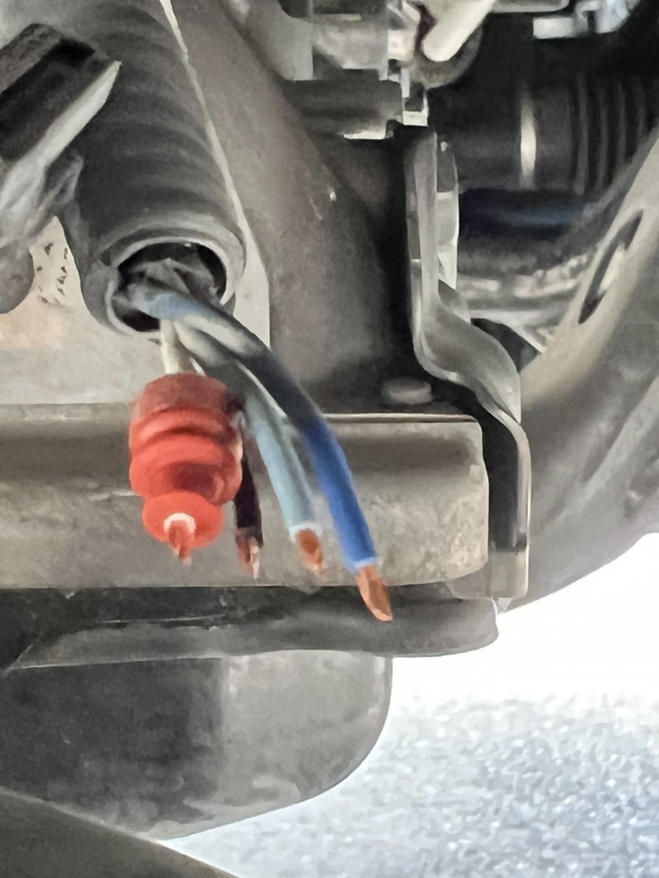

    Last week somebody tried to steal my catalytic converters , but they couldn’t.
    My problem is that they Broke the female plug for o2 sensor , and I have no idea how to connect them back on the right place .
    Dealer and insurance wants my kidney for the 4 pin conector
    Help please
    I’m 4x2 4 cylinder

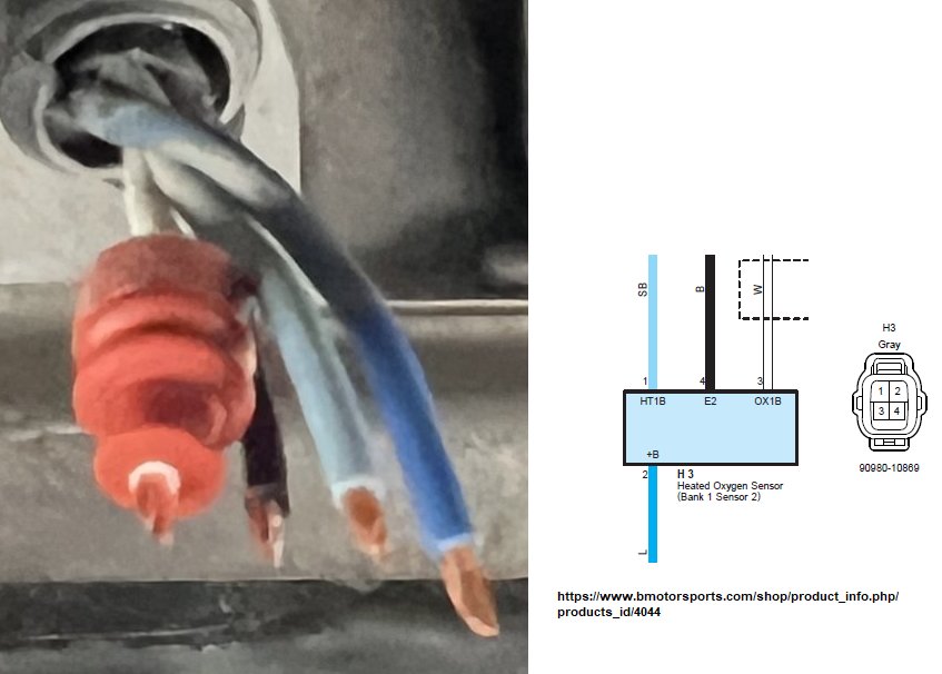

    Is back on place , now I have to reset the check engine light .
