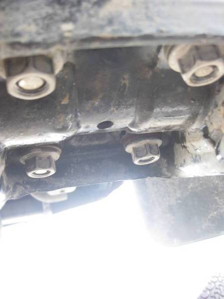

  15. Oct 14, 2009 at 6:09 PM
    NicksRig
    NicksRig [OP] Well-Known Member
    Oct 14, 2008
    #9966
    713
    Kenora, Ontario
    07 Tacoma DC TRD Sport
    Blacked out Skid plate, block heater, bug deflector, blacked out headlights, tinted fronts, OME 3" lift, Toytec AAL, Revenge-Fab Sliders, K&N Air Filter
    Here is a pic of the bolts.
    Now I have my front end partially taken apart and I am having trouble disconecting the UCA. I can't seem to get it to move, tried hammering it. Any other tips?
  16. Oct 14, 2009 at 6:15 PM
    #16
    SC4333
    SC4333 Well-Known Member
    Dec 9, 2008
    #11412
    2,267
    Grant
    San Antonio, TX
    2016 TRD Off-Road 4x4 DCSB - Super White
    Using a puller is the proper way to go about things when removing the UCA from the spindle although you can get by with giving it a good hit with a hammer. Just be very careful not to damage the threads on the bolt. If you have a parts store that rents tools, a puller is well worth it if you are having a lot of trouble getting everything separated.
    Did you get longer U bolts with the AAL? You shouldn't reuse the original U bolts, not to mention you will need extended U bolts. The ones you have in there dont quite look long enough from what I can see.
  17. Oct 14, 2009 at 6:20 PM
    #17
    NicksRig
    Oct 14, 2008
    #9966
    713
    Kenora, Ontario
    Not sure what a puller is. Do you have a picture? I was told that I did not need to get new u-bolts with this kit.

  20. Oct 14, 2009 at 6:53 PM
    #20
    chris4x4
    chris4x4 With sufficient thrust, pigs fly just fine. Moderator
    May 8, 2008
    #6497
    108,587
    FlimFlubberJAM
    Tenoe, AZ
    2013 Rubicon Unlimited,
    4.10 gears, sliders, and lots of buttons.
    Place something on the bolt to protect it....hard platic, wood, etc....and wack it with the hammer.
    And X3. Your U bolts are way to short.
