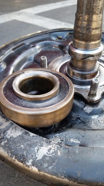

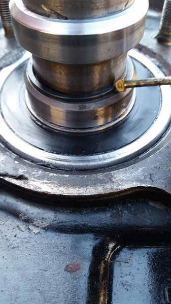

    20170428_083456.jpg 20170428_083537.jpg my bearing is up side down correct ?? The f shop put it wrong . Can believe i didn't check going back for a fight nowww . The case bearing as lots of play . I shold get a new one right? ?

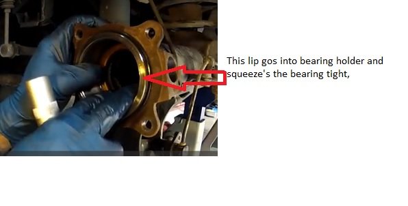

    The end of the rearend tube has a lip that should go ing and pinch against the outer edge of bearing. To hold it from moving lile that. But something looks off. Is there a snap ring holding bearing on shat? Let me research it a bit.

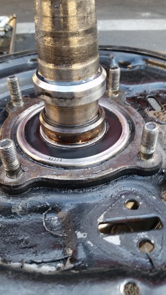

    20170428_092316.jpg yes snap ring is there . Can u see it ? I just order the parts. Case bearing an bearing too

    Ive read that the bearing case play doesn't matter that much since it gets pushed against the axle flange. The more important thing is the axle seal that rides on your inner retainer. A lot of shops don't get these in the right place which allows gear oil past the retainer and into the wheel bearing. It then goes through the wheel bearing and into your brakes.

    Nzbrock. I try the original seal too. but can see the bearing install up side down

    Toyota describes the "fit" of the bearing case to the bearing as a press fit. In many cases a nice clean new (OE Toyota) bearing will slide into the case with just hand pressure. I have seen this many times with no issues down the line. However there should be no detectable play between the bearing and the case.
    The bearing for 01 and up does go in one way. Couldn't say which way, all my experience has been with pre 01 rears/bearings and they are the same on both sides.

    Dirtypool yes thats my truck as the abs ring but my dont have the abs. The play on my case bearing is to much i think like 1/2 inch or less looks like not correct . Aim getting a case bearing an go from there .

    The looseness your concerned with is normal. The axle tub locks it down.

    Looks like i need a axle shaft my as a small bent ... i roll it on a smooth surface a i see the gap . Anyone have a spare one ??

    I bought an ABS version of the kit and everything checked out - high quality Koyo bearing, OEM seal and tone ring, all Japanese made parts. It might be worth giving them a call before ordering a non-ABS kit if there are multiple housings for non-ABS trucks, which I am not sure that there are or how that relates to the direction of the bearing.
    Went through this with my 01 ABS axle - it had some wear from the bearing rubbing on it and trying to find a non-dealer replacement was a hassle. Ended up returning a junkyard axle that had even more wear than my original axle and ended up putting the original back in. There are no good aftermarket replacements for ABS axles and an online parts dealer wants $400. You being an 01 non-ABS truck I'm not sure if this is an option, but I wish I had been able to go with these:
    http://www.rockridge4wd.com/i-22813...-runner-prado-t-100-tundra-25-7-8-32-1-8.html
    You can get 2 stronger chromoly axle shafts than OEM for $50 less than the price of one. You'd most likely have to call Nitro (I wouldn't call the retailer since they won't know the product as well presumably) and find out the measurements for the bearing and snap ring placement. I hope you find a cheap replacement.
