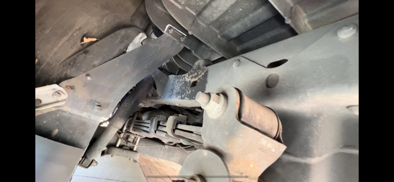

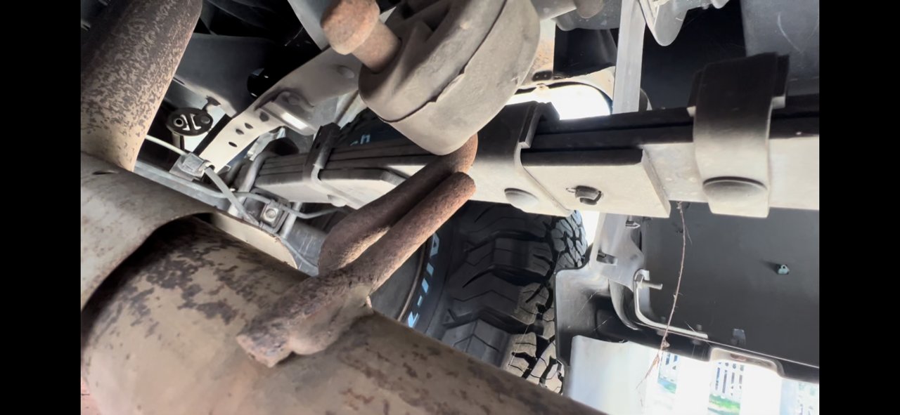

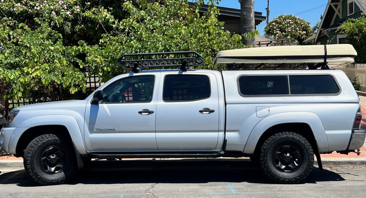

    I have a 2007 2nd Gen Tacoma Double Cab Long Bed 2WD. It has a camper shell on the rear with a hard top tent on top. The tent is first gen and very heavy. I also usually have a bike rack on the rear with an e-MTB on it. This is my daily driver but also my weekend warrior and a few trips to the beach during the week.
    The springs are completely flat and I've been researching suspension upgrades of new leaf springs vs helper springs vs air bags vs....
    I do a lot of camping and mostly head out to the Anza Borrego Desert (Blair Valley area) when I can. Nothing too extreme for offroading hence the 2WD. Mostly fire road with sand, some ruts, and washboard.
    I'm fairly handy and have done all the repairs and maintenance on my Tacoma myself, including simple wiring. I feel fairly confident I can replace the leaf springs myself with the help of a friend.
    I ended up here: replacing the leaf springs with the ARB Old Man Emu Leaf Spring - Heavy Load - EL112R but wanted to get your input on what you would do or any suggestions. Eventually, I plan on getting a 4x4 (after all my kids graduate from college), so for now it is my 2X4 and I, and I just want to make sure it is safe.
    Thanks for taking a look and giving me some advice/input.
    Cheers.

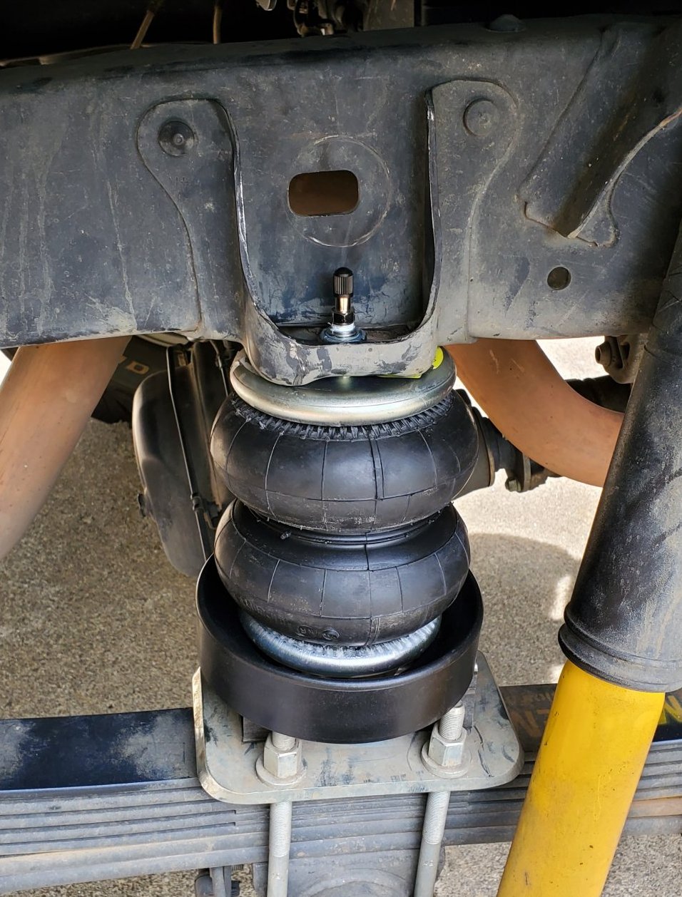

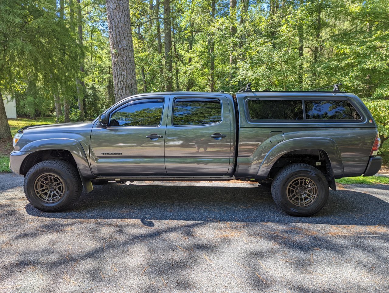

    At a minimum go with full leaf replacement. I went with the Heavy Duty OME Dakar packs and even those started sagging after about a year with my load out:
    Recently added Firestone airbags with Daystar cradles:
    No more sag and now I can make adjustments depending on the load:
    Dekoy909, gilligoon and Ricardo13x like this.

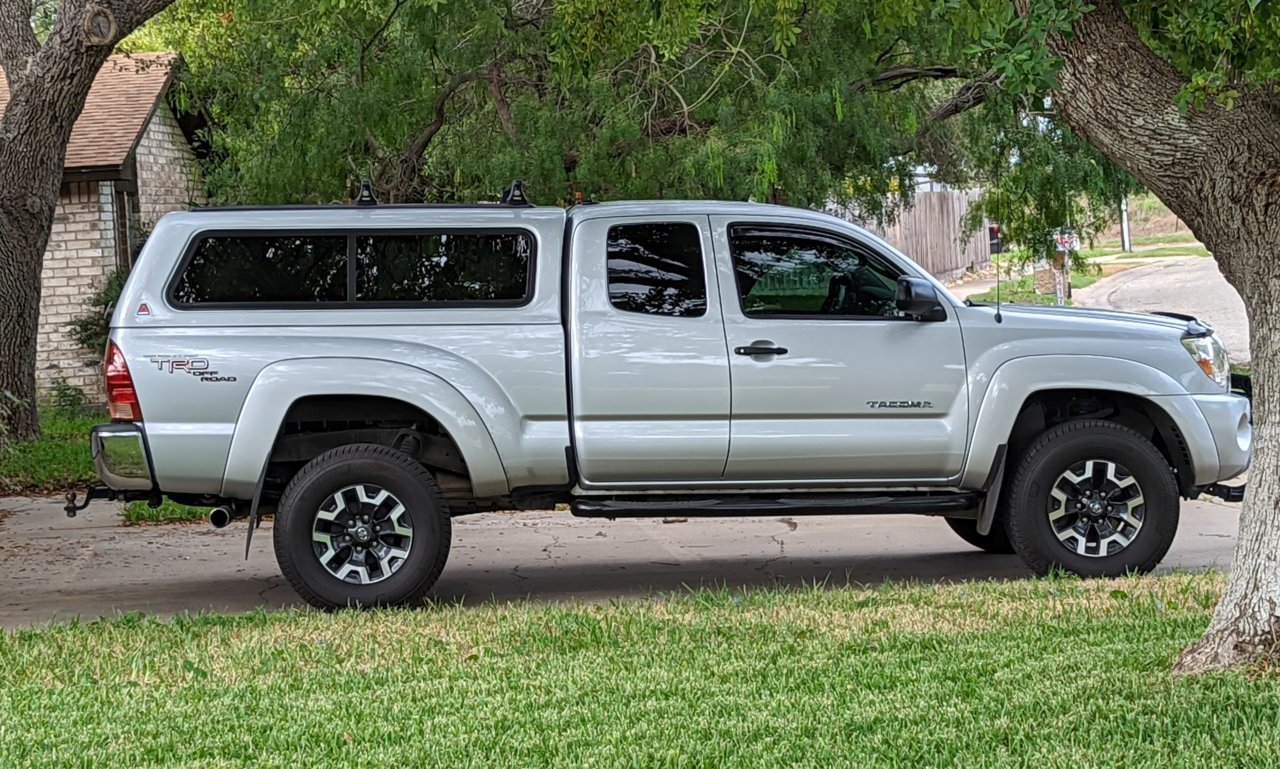

    Dobinsons is another manufacturer of leafs springs for our trucks. https://www.dobinsonsdirect.com/pro...pair-for-toyota-tacoma-2005-to-2019-l59-112-r
    I was checking them out when shopping for some new leaf springs on my 07 Prerunner. That was until the recall leaf packs were put on and I added an AAL along a set of the blue Sumo Springs. I went with the Sumo Sprngs for their simplicity and zero maintenance once installed. https://www.superspringsinternational.com/sumosprings/
    I don't run with a RTT, but carry a few containers of full of gear (100lbs) along with my cap (200lbs) daily. Then when I'm taking off somewhere there will be at least one dirt bike on a hitch carrier or two dirt bikes loaded on a trailer along more camping gear in the bed. There may be a little rake when not fully loaded, but definitely no sag when heading out for another adventure.
    If you don't already have, you might want to consider a set of bed stiffeners. Plenty of them out there. I went with CaliRaised, now in TX. https://caliraisedled.com/products/...lIO8HKzD0aAnPLEALw_wcB&variant=11689196552234
    Taco under trees at home2.jpg Daily load
    TacomaKDX up close.jpg One bike with a lot of gear in the bed.

    @Gallowbraid What Ubolt flip kit you using and what kind spacer you use between that and the cradle?
  15. Sep 2, 2022 at 9:35 PM
    Gallowbraid
    Gallowbraid Known Problem
    Nov 12, 2015
    #169439
    163
    That's Trail Gear's flip kit with a peice of 1.5"x2" .120 wall rectangular tube acting as a spacer. It's bolted to the plate where the bump stop normally would. That's temporary as I'm putting together a solution that will integrate a bump stop as well and more fully support the cradles.

    Why would you need a bump stop with the air bags there? Air are suppose to always have at least 5 psi in them. I always assumed it was because of the bump stop removal.

    163
    It's still possible for the daystar cradles to bottom out. Without the cradle it's probably not necessary.
