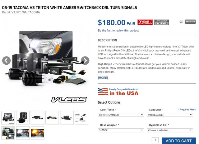

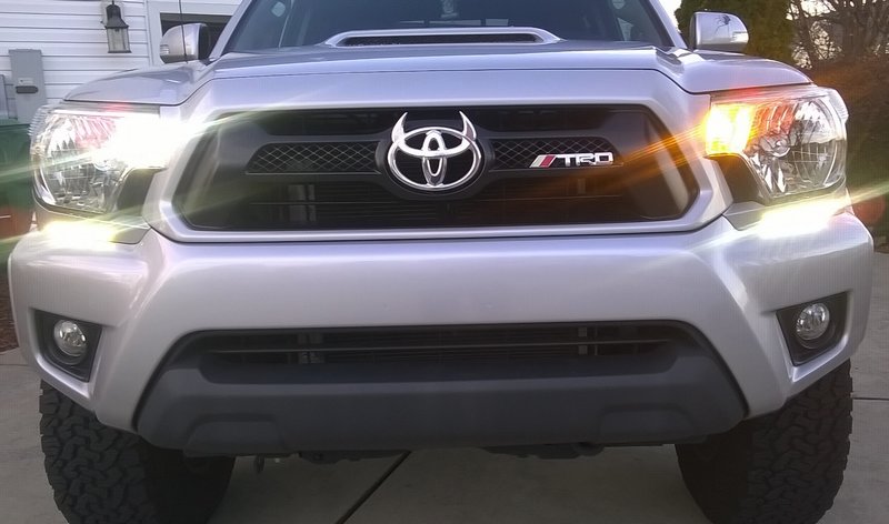

    If it's with 2 wires then it may never work properly. At least I couldn't get my (3157CK) daytime running / turn signals to work. I either got White solid and flash or Amber solid and flash. The only way I solved the problem and got the bulbs to work properly was to upgrade to VLED's
    switchbacks which compensate for the 2 wire Toyota harness. The're not cheap but great quality all plug and play. Even the resistors to stop hyper flash.

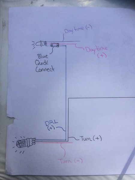

    Cool. Can you give an example of how you now have this light wired? Wiring diagram?

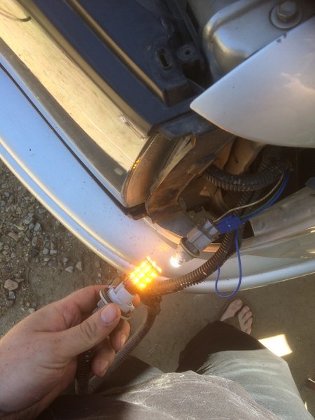

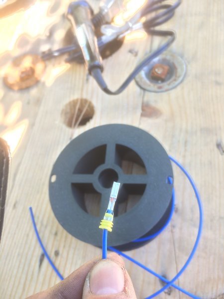

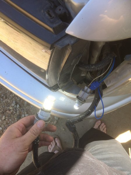

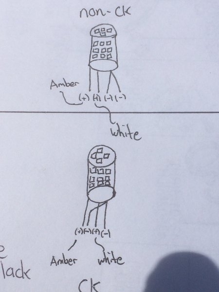

    Attached are a few pics of how I did the wiring. The colors of the ink don't match the colors of the wire. The wiring is pretty straight forward the only thing I did that I haven't seen others do is use the actually crimp connector that goes into the factory connector. Others have just shoved a wire in there and it worked but since I have the tools I figured it would be the better way to go. The hard part was requiring the bulb itself. I used a thread I found on tw to do it. Just google tw how to rewire 3157 non Ck to Ck. I attached a pic for reference.
    Everything is ran through the factory wiring loom so it looks factory. You could never tell it wasn't there before.
