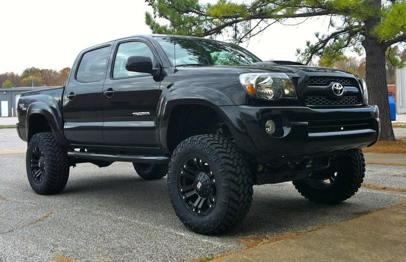

    BenWA
    BenWA Well-Known Member
    Feb 23, 2009
    #13977
    1,588
    Seattle @ 0.9 Mach
    '06 Double Cab TRD Off Road 4X4
    Agree.
    I think Sandjunkie is running a 4.5" RCD on 33" Duratracs, and his truck looks badass:
