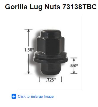

    I was gonna grab a set of black lug nuts to match the new rims. Any info on a quality brand or anything specific I’ll need?

    M12 x 1.5
    If they're Toyota OEM Pro wheels you'll need a shank seat (flat seating surface), not cone seat like aftermarket wheels.
    Like these -
    https://www.summitracing.com/parts/gor-73138tbc

    And yes I bought the OEM wheels, perfect! Thanks again for your help!!
