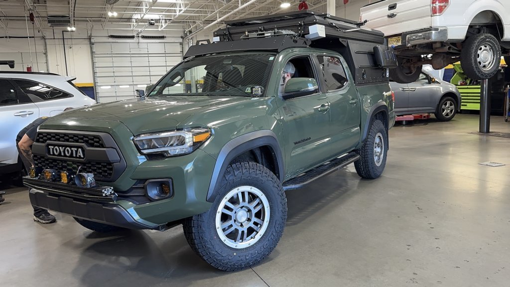

    Pizza cutters. Your gas gauge will thank you. I have 1" spacers and only had minor rubbing on certain turns at different parts of suspension compression. And they work great off road, there are few things that may trip you up.

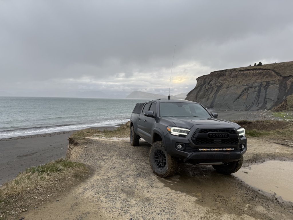

    265-75-16.. been happy,

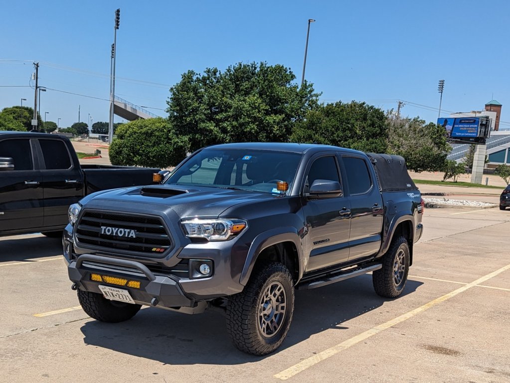

    I've got a 2.5-3.0'' lift with 255/85/16's. These are mated with Method 701's and JBA upper control arms.
    No issues with rubbing on, or off highway.
