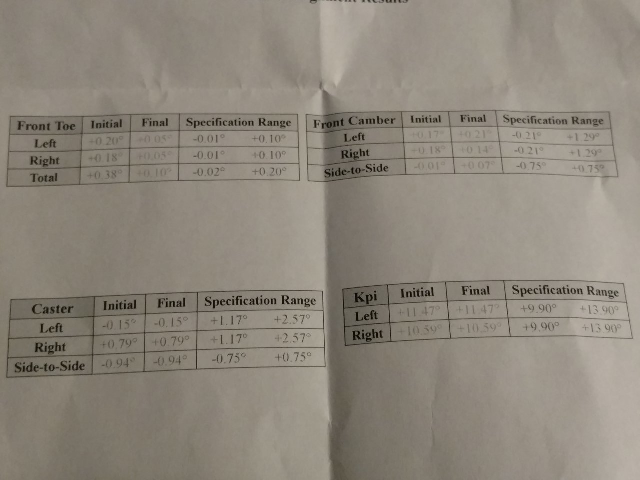

  5. Aug 10, 2017 at 3:48 PM
    tracker366
    tracker366 [OP] Well-Known Member
    Mar 13, 2011
    #52948
    190
    Steve
    Bourbonnais,Illinois
    2017 Access cab TRD Off Road
    Just had the alinement checked here are the results. Looks like I'll be getting UCAs

  9. Aug 10, 2017 at 4:25 PM
    Justinlhc
    Justinlhc Not looking for a relationship
    Jul 7, 2015
    #158945
    3,512
    It would help if they actually TRIED to adjust the caster/camber. :frusty:
    You got the "Toe&Go" alignment.
    Are your LCA eccentrics seized?

  15. Aug 10, 2017 at 4:41 PM
    tracker366
    Mar 13, 2011
    #52948
    190
    Steve
    I'm calling them tomorrow and ask why.They didn't even say if they were seized or not, Guess I should have looked at the paperwork before I left.:homer:

  20. Aug 11, 2017 at 2:07 PM
    #20
    nm4553
    nm4553 You had me at "Meat Tornado"
    Jan 5, 2015
    #145655
    766
    Nick
    NEPA
    2017 DCSB TRD Sport
    SCS Stealth 6 Matte Bronze on Toyo Open Country 265/70R17, Fox 2.5 Coilovers, Bilstien 6150 w/ Remote Resi, Dakar Leaf Pack, Wheeler's Bumpstop, OVTuned
    I'm not so sure you even need new UCA's to get the alignment within spec.
