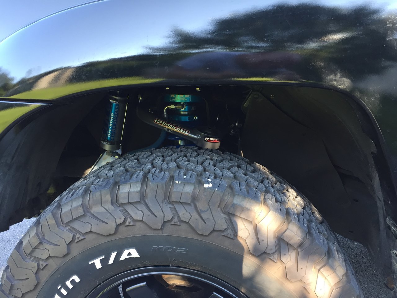

    Worth the extra couple bucks just for the coolness factor.

    Exactly what I'm replacing after a year, I barely drive over leaves and already have a ripped boot, and ball joint issue. Replacing with JBA's on Sunday. So now if a ball joint goes bad I can do it right in the driveway without taking the arms off . Can't do that with Camburgs.

    Those are uniball soooo there are no boots to rip. The uniball is held in by a snap ring and I bet you I can replace it on the vehicle.

    That's good I won't do uni balls on the East coast with all the salt

    I've heard of too many failures and too many warranty returns on them. Yes I know a lot of people run them with no issues, but when you hear the same issues with a product repeatedly you tend to start wondering. Damn the internet..
    I've had the balljoint move in the slide when off-roading and had to over-torque the piss out of them(which also worries me)to get them to stay put. I know exactly where mine are set, but I still don't trust the slide 100% knowing a big enough hit is going to send me into extreme negative camber/positive toe territory.
    Also, if I'm in desperate need of a replacement LR balljoint it's going to be at least 2-3 business days before I can get one. The JBA arms use a readily available balljoint that will likely be in stock at most any auto parts store.
