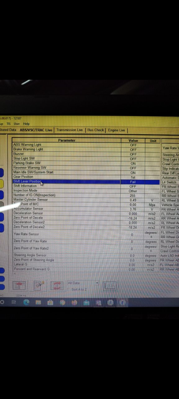

    Attached is a picture of live measurements, maybe someone has a picture of their Tacoma so I can compare it

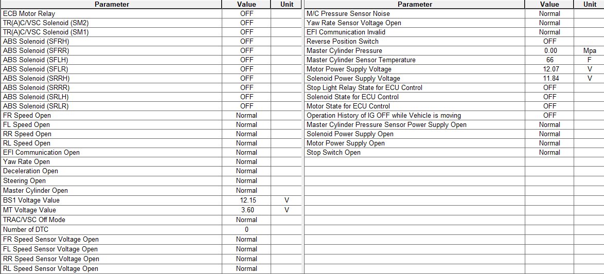

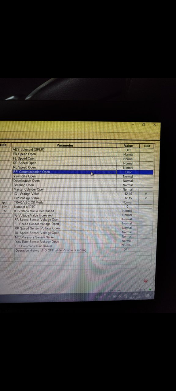

    maybe one of you can send me a picture of your live data from the VSC/ABS ECU (ignition on and gear in P)
    I think that would help

    Just because Germany out of the WC...
    here is mine, but it is SR5
