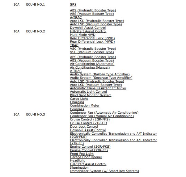

    this is 2016-17.
    TnShooter likes this.

  9. Dec 5, 2022 at 11:23 AM
    #29
    Vlady
    Vlady Well-Known Member
    Dec 20, 2017
    #238986
    4,645
    Issy, WA
    2017 White SR5 DCSB V6 4x4
    Have you try to pull ECU -B 1,2,3 fuse to see if this resets VSC control unit?

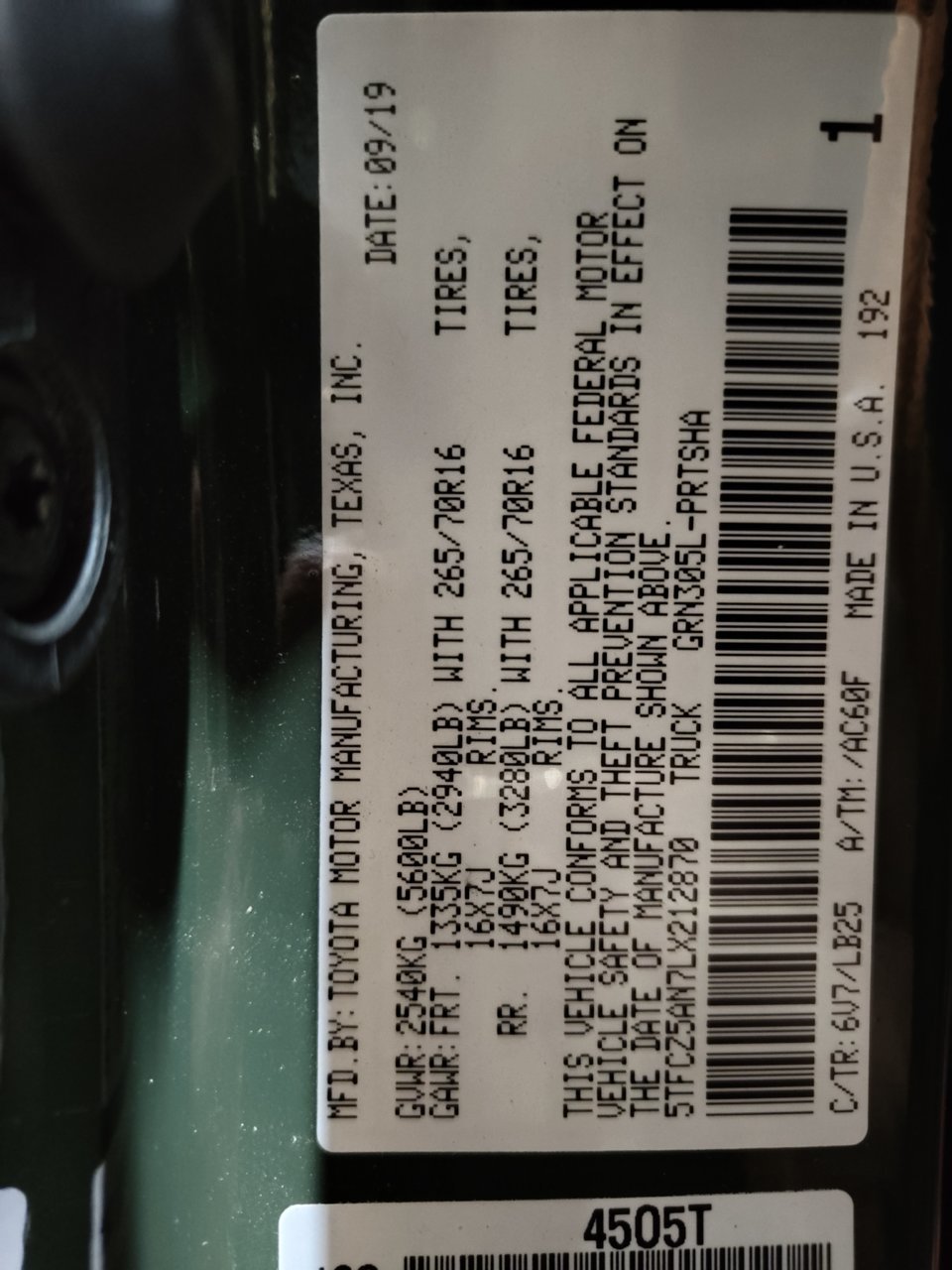

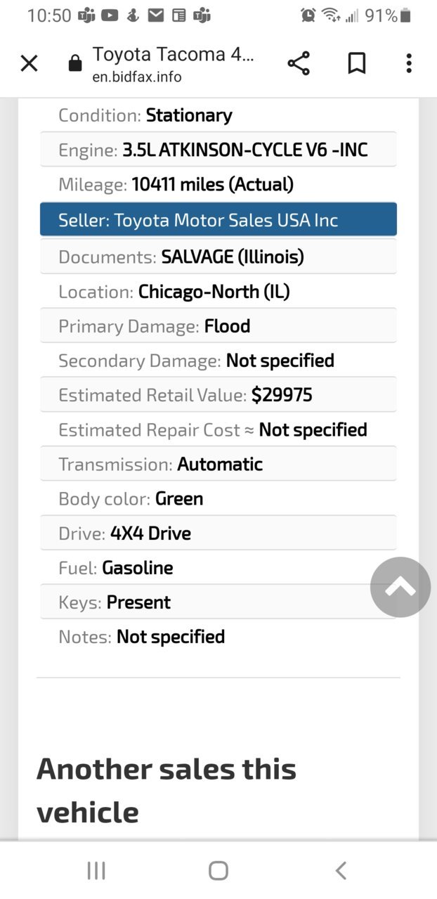

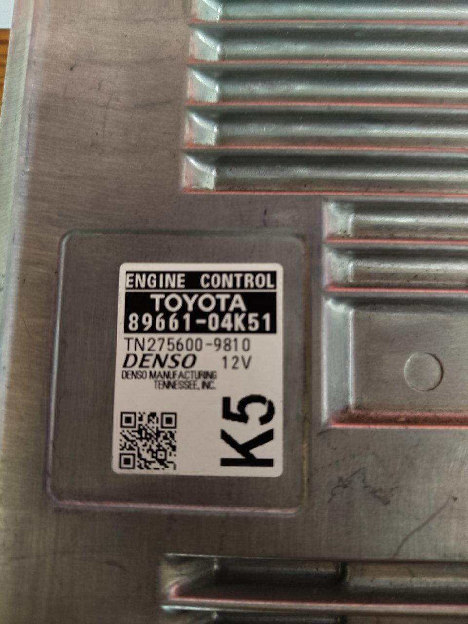

    I just took a closer look at my engine ECU and looked up the part number on the internet. I was told that the part number does not match my vehicle at all, the part was only installed up to 2018 and my Tacoma is built in 2020.
    Maybe that's the mistake?
  20. Dec 6, 2022 at 10:53 AM
    #40
    Vlady
    Dec 20, 2017
    #238986
    4,645
    Issy, WA
    So it is an auction car -flood victim. Or water crossing gone bad.
    Yes, they probably put thing together to get it running. Pull the ecu calibration id and tcu calibration id. You may need to replace ecu and do trim specific calibration id.
