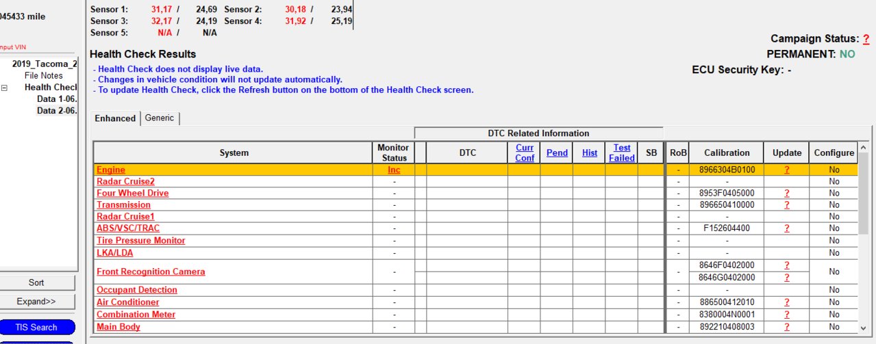

    Here are all the calibration ID's that I read out.
    What needs to be done if I want to install a new ECM

    Damn, they put original 2016 calibration . Does it even drive?
    I think you need to look for 2020 ecu and get the most recent calibration. Then start with the troubleshooting.
    Question: is VIN on ECU matching the window's plate? Any signs of altercation on the harnesses?

    Make sure you sort the model year. Based on you health check , it is 2019. Production date September 2019 on the door sticker. Did you manually enter the year in techstream?
    Not sure why it is marked as 2020.

    I entered the year manually into Techstream and there's a fob on my car key from a dealer that says 2020

    I don't know if it's 2019 or 2020, but I think: production date 2019 and first registration 2020 (it's in the vehicle documents)
