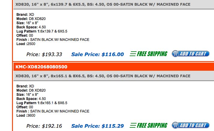

    I'm trying to order some rims off 4wheelonline for my 2015 taco but have no idea how to fit the specs looking at the details of the rims not sure what the lug patterns and lug distant ratios are this is a random screen shot just for example

    You need 6x5.5 (6x139.7)
    First number is how many lugs the hub has, the second number is the spacing.
    As for back space/offset, maybe someone else can chime in for what you need.
