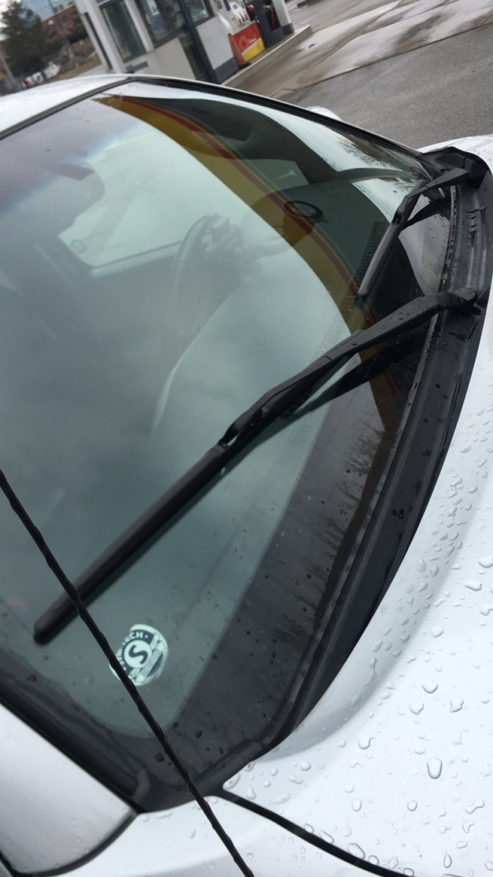

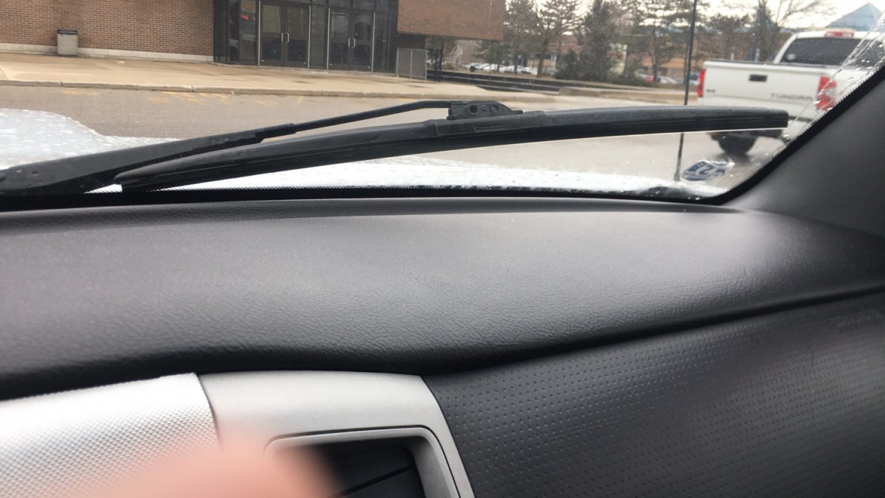

    My wiper has always been like this for as long as I’ve had the truck, it’s just the one wiper like this. Today I tried to use my wipers and they went extremely slow, like very very slow which hasn’t never happened to me before. Is it an issue with the motor for the wiper? Looking for a cheap fix

    Take it off the spindle. May not be aligned properly. Does it go up past where it should when it wipes?

    It’s radius reaches the very top of the windshield
    Is it easy to take off the spindle

    The nuts that hold your wiper arms on are loose, adjust the wiper at the resting position where you want it then tighten the nut down on the wiper arm.

    This is not a common issue that's brought up that I know of. They definitely sit high on the windshield. They should be tucked down further. Could be the wiper motor or just misaligned.

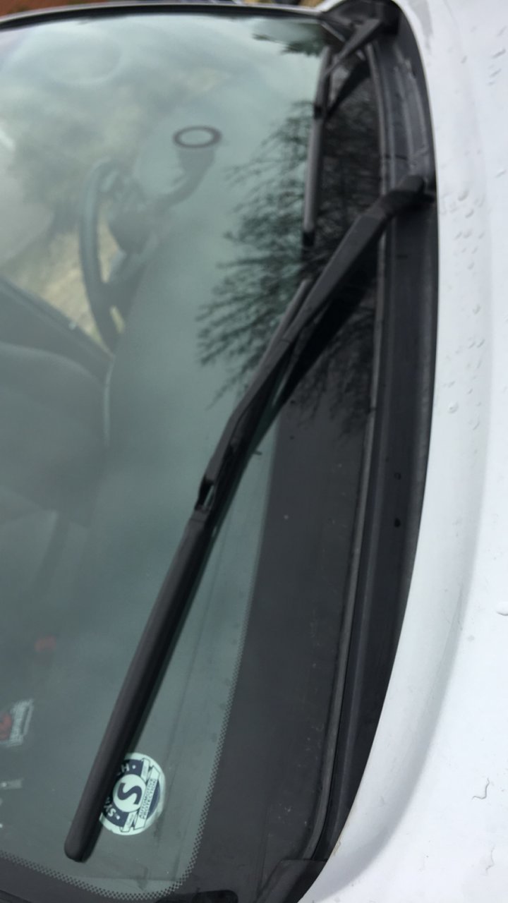

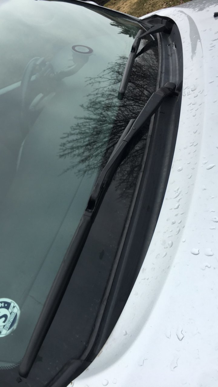

    After adjusting

    Wait, did you solve it? Hard to tell. Looks like it from the first picture, but what about the second picture? Or are they posted out of order?

    I adjusted it so it was perfect but now it’s back to looking messed up in the 2nd pic, even the other wiper is a little low now

    As mentioned above, check the splines and nuts really good, make sure the stud isnt spinning in there. If everything is tight you may have a wiper transmission problem.

    hit your mist wipe once to cycle the blades again. Ill get my passenger side to sit high every now and then, one tap of the mist to cycle things once will usually make it to where things go back in place proper.
