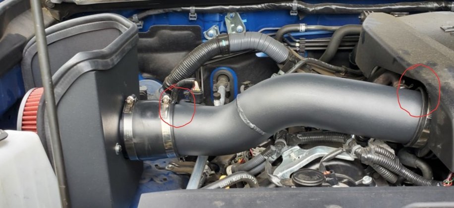

    Yea I mean typically on a hose clamp, when you see the rubber protruding through the openings in the band you'd think it was tight enough. Obviously not though.

    I'd check these two areas (circled in red).

    Just an update:
    I went home this morning after work, disconnected the negative terminal from the battery, waited about 10-15 mins, reconnected, and for now it seems to have cleared up the issue. I also readjusted the rubber tube and the clamps (tightening them a bit more).
    What was so strange was when I was driving home this morning, the TRAC OFF light would go off for a few mins and come back on.
    But when I got ready to go to work this afternoon, I drove around a bit extra just for chance, and it never came back on. Hell, I even sat at Sonic Drive in for 15 minutes waiting for a quick bite with AC on and all. Still, no lights or issues.
    So I'm hoping the battery reset everything and cleared things up. But knowing my dumb redneck luck, it'll resurface somewhere down the road. :rofl:

    Excellent Jason! I'm a huge proponent of less is more and sometimes, no, most of the time, digging deeper for me only causes more issues.
    Drive it a while and see what happens. Don't be tame with it either. Find a safe place and really get on it, but my guess is, you had the slightest amount of air leaking in those spots and that was throwing it off.
