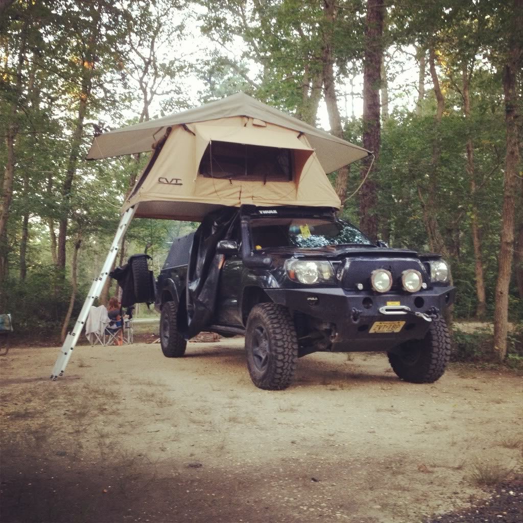

    heres my DCLB with 5100s set to 2.5 and an aal in the rear. 265/70/17 duratracs.

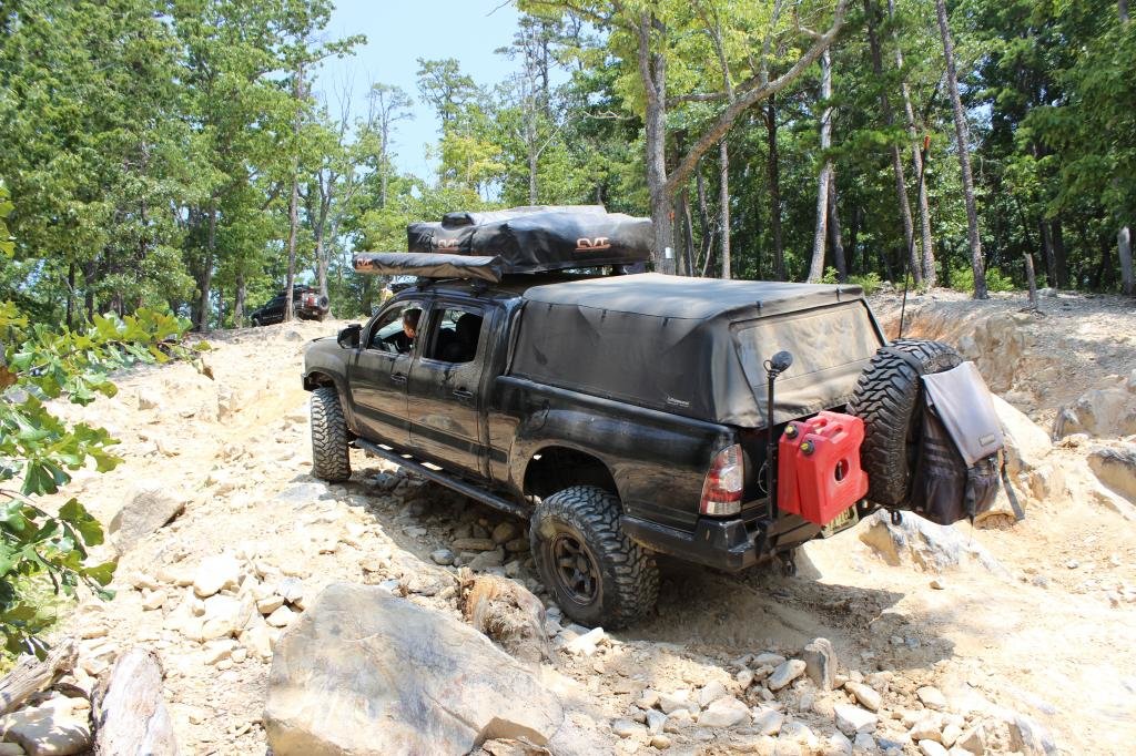

    same tires but with fox remote resi shocks and all pro expo leaf pack. 3" lift in the front, 3/4" lift in the rear

    Nice truck, thanks.
    Would a 3" in front and a 1" in back pretty much look the same?

    I think you'll be high in the front if you do that.
    2.5" front, 1.5" rear seems to level it off.
