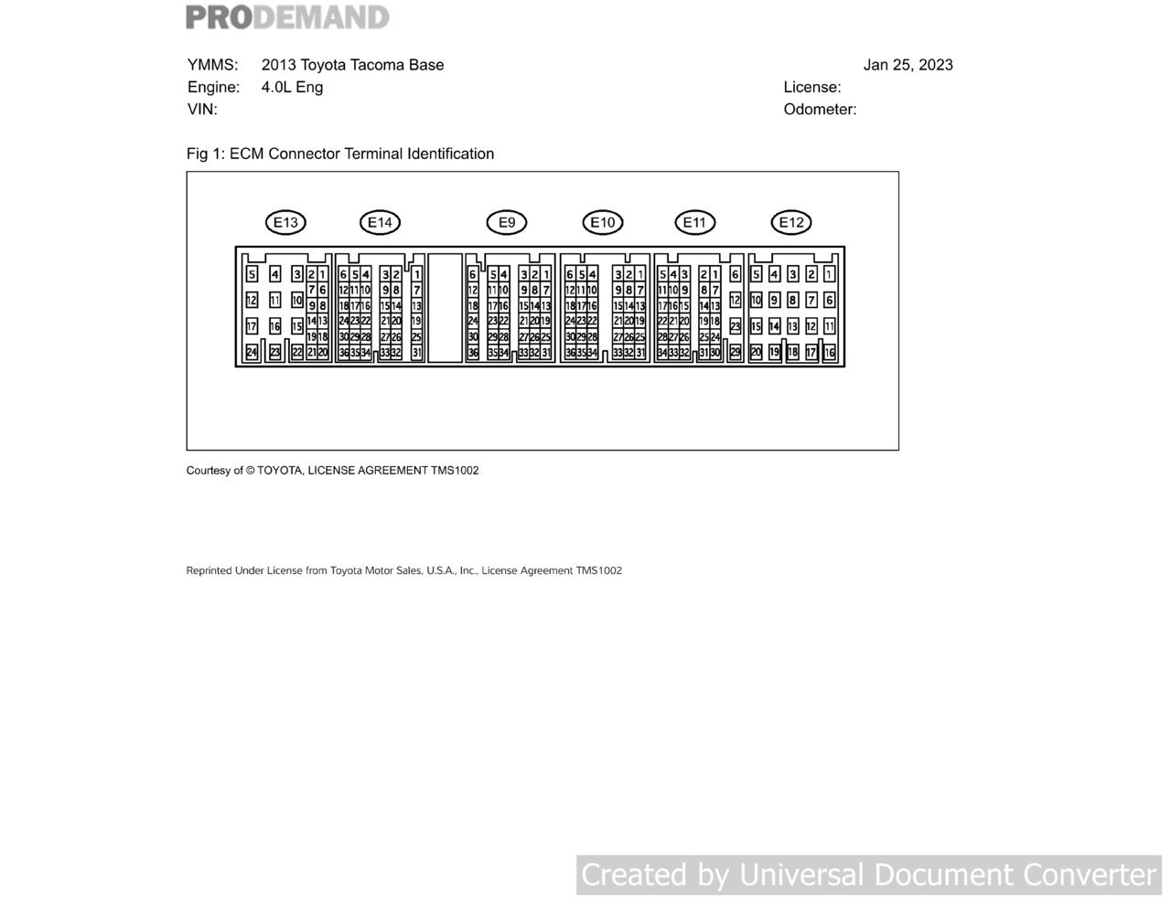

    Are you still setting a crank sensor code when it won't start?
    You can use needles to backprobe the connector pins to check the circuit.

    Yes the p0335 is still there. I will try the needle trick soon as i can. The fuel pump is new complete unit.

    Need to properly diagnose the crank sensor code, if the wiring checks out there's really not much more you can do to check the crank sensor without a scope.

    The crankshaft position circuit matched the new sensor 2140 ohms.
