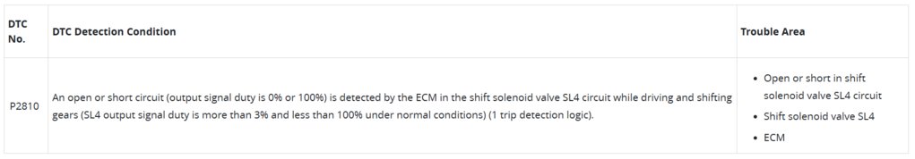

    My track off light is on engine light is on I have a code P2810

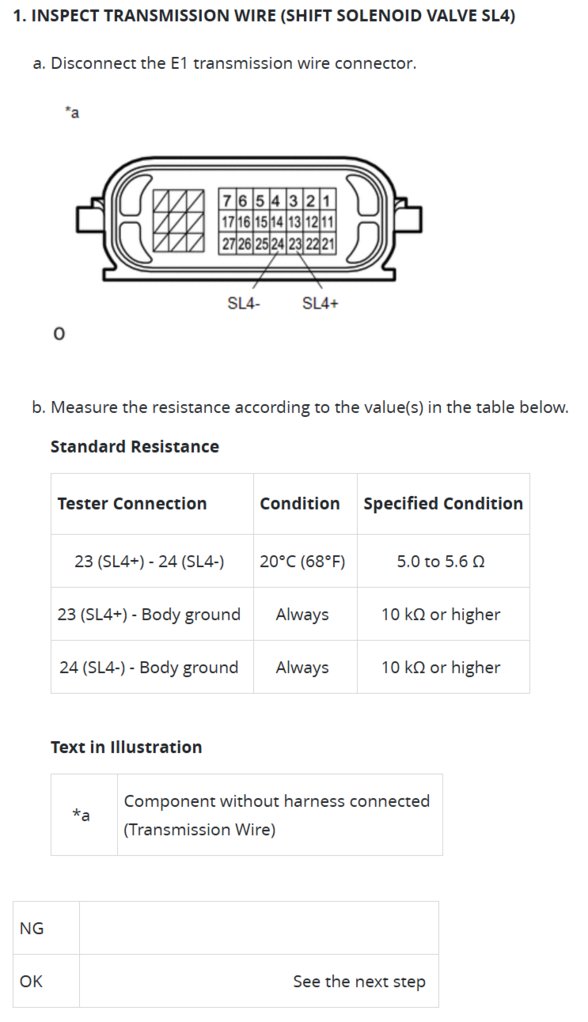

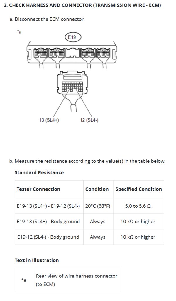

    Not exactly an easy one diag over the internet (or at home).
    First step would be checking the wiring to the transmission for damage.
    Then unplug the connector and look for corrosion.
    Then the pins on the connector shown below. (the transmission side)
    You really want a Scan tool to see what's happening.
    But a cheap voltage meter works for the basics.
    Going further than the checks below involves dropping the trans pan.
