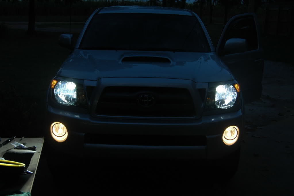

    I went with the white 5000k Raptors from DDM Tuning. Shipping was fast, the install was simple, and they worked great!
