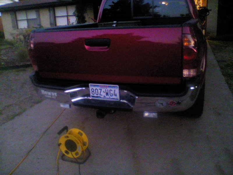

    heat it with a heat gun take fishing line go behind and it will slide off take wd40 to remove leftovers just did mine about a hr ago i sanded chrome emblems took the ma off the tacoma paint it black and gona put it under the tailgate handle

    just gona do taco on tailgate will get a pic tomorrow need to get some new double side tape

    removed all badges, cut the ma off with hack saw than took a file to clean it up, sanded badge with 400 grit and painted, gona get some double stick tape tomorrow and put the painted taco badge about 2'' under the tailgate handle in the center

    From this
    to this
