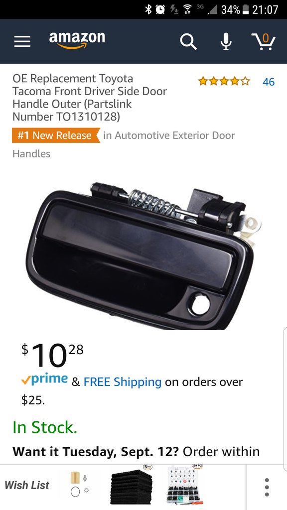

    I also remember the time when I would try to fix it too. There were times when $10 didn't seem like much but it is if you don't have it and have other priorities. :frusty:
