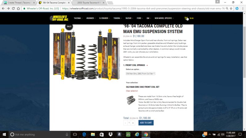

    This would be going on my 2003 Double Cab TRD/SR5 4x4 3.4L with 247,xxx miles. Looking for mild lift and leveling. Currently have stock set-up with 265/70/R16 tires. Possibly larger tires to "fill'er up"? Good combo?

    I've installed 2 of these. You can do it by yourself if you have a day. Make sure you get them to assemble the struts for ya. Works fine as it gives a 2 in. lift.

    Anyone else with any input on the attached set-up? Will it level AND lift?

    If you're going with 882 front springs you can fit 255/85/16 with little to no rubbing Look up 255/85/16 1st gen tacoma. Expedition portal has a great write up on fitting them. There is also a thread on 255 fittiment in the wheel and tire section on TacomaWorld. Hope this helps !

    Does it "level" the truck out also? I've read that even after installation the rear may still be a little higher unless you add the, I believe, 5/8" spacer over the front coils.

    Wheelers Offroad installs the spacer automatically (they did for me on both orders) so that is not a problem. Make sure you install them on the correct sides. It will ride rough for a while until it settles in, but hell, it's a Truck.
