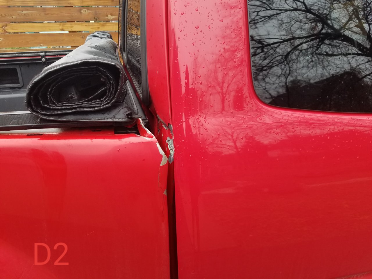

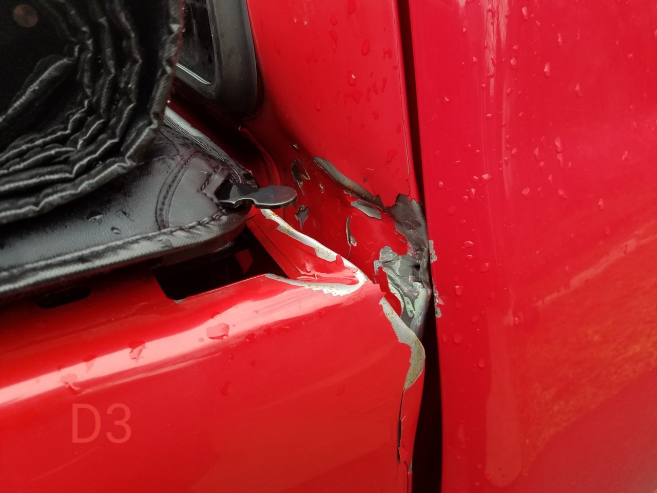

    Say goodbye to it, safe to assume the bed hit the cab as well.

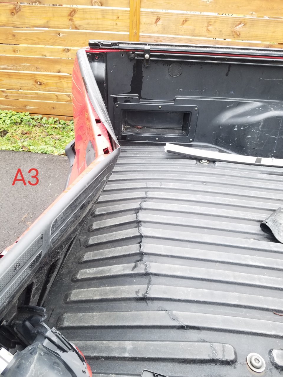

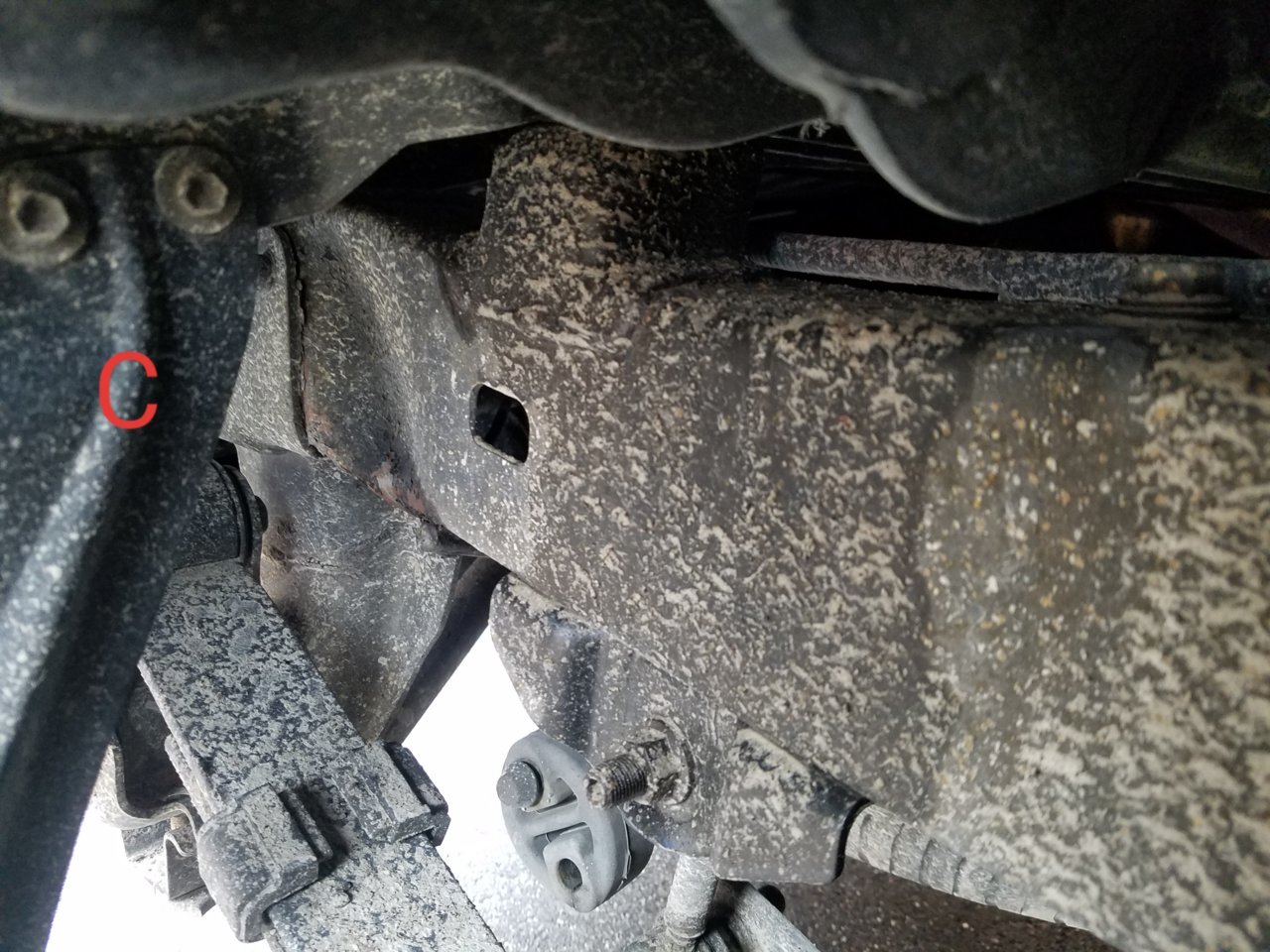

    Is the frame bent, and did the bed make contact with the cab? More pics!

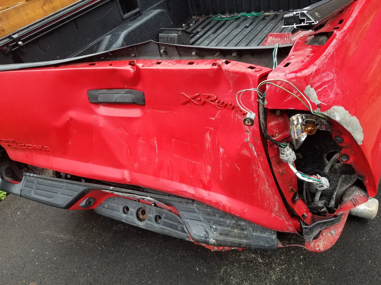

    I'd make a bet with the bumper rolled under like that, the frame is bent between where the bumper mounts to the frame and rear spring/frame mount.

    Frame is definitely bent. That is obvious by having both the bumper and back of the bed (note where it cracked) aimed towards the pavement. Now, depending on damage further forward, this could be a candidate worth saving if you can get a line on a new bed.
    If the $ and time are available, back half the frame and install airbags with a triangulated 4 link.

    thanks for all replies... I think I could fix it just didn't have much time coz I work full time... the frame on the right side is bent a little, the cab has a minor dent, airbags were not deployed and the truck is still running well, the body shop said changing the entire bed makes the repair 75% done

    While I don't doubt that in terms of 'visual bulk' of the repair, and the easy peasy bolt off and bolt on of a replacement bed, it's the other 25% that is the killer in this case.
    That being the frame. Thats where the time (and time = $) and skills to do it right come into play.
    And at the end of all that, you have a salvage title vehicle with a 200k driveline.
    Salvage title generally means it's worth about 1/2 of market price, and in some states I understand that insurer's won't even write coverage. And as far as selling it, you'd be pretty much limited to a cash buyer, as lenders balk at a salvage title.
