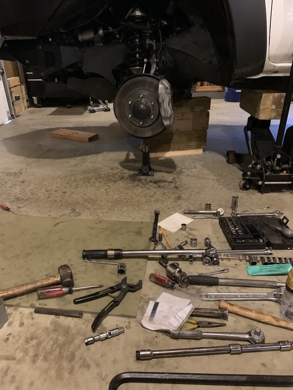

    I wouldn’t locktite anything.
    I would lightly anti-seize all sleeves, collars, shanks and faces, but not threads.
    Then I’d slide a little jack under the LCA, lift it to close to ‘ride height’ (with the truck still on blocks), and torque everything.
    Test drive to the beer distributor and check for any weirdnesses.
    In a hundred miles check all the torques.
    but that.’s just me and a I’m no expert

    I just did a shock bearing on my truck. Here’s my little screw jack under the lower arm to lift it up to ‘ride height’. The frame is still on the blocks and big jack.

    Thanks. That's my favorite part!
    Makes sense. Sound like full weight of the vehicle is not needed to "set" the LCA then.
