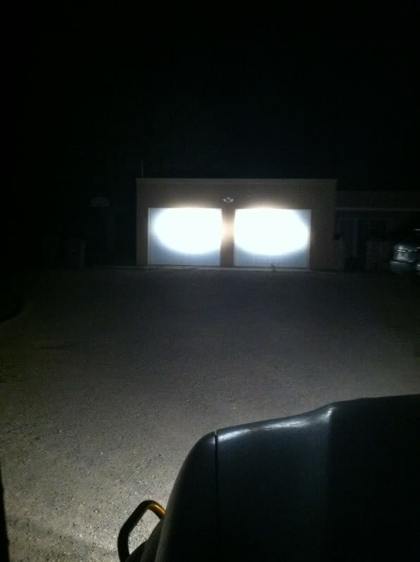

    here are my 2 KC daylighters, there obviously the long range beam pattern. my garage is about 100 ft away from where my truck was

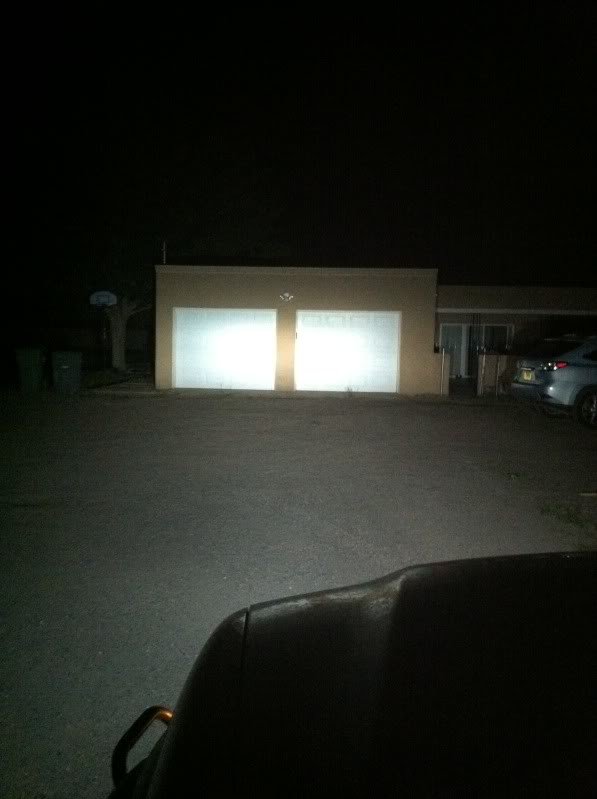

    these are my 35w HID headlights.
    but if you want most light output with lowest power then HID is your best option. here is a thread where you can get some ideas http://www.tacomaworld.com/forum/lighting/131486-show-off-your-lights.html
