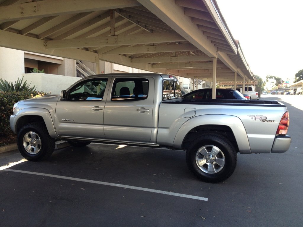

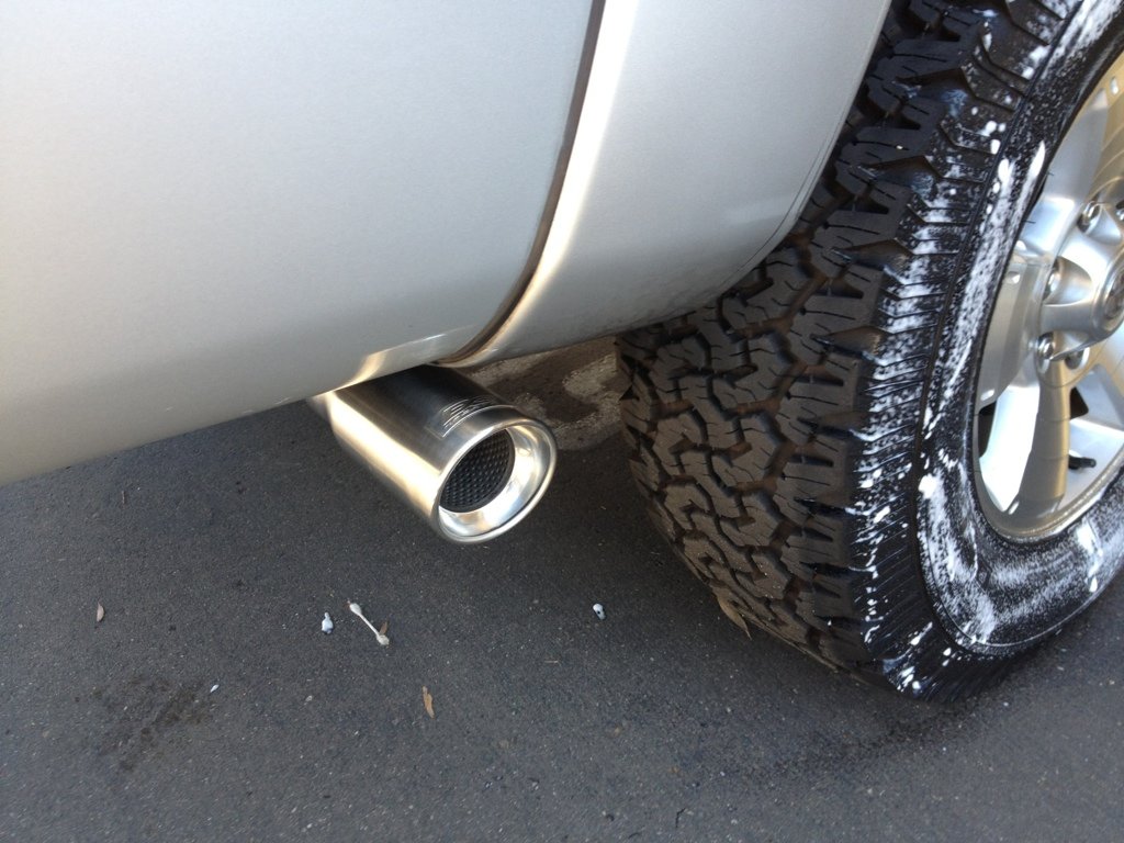

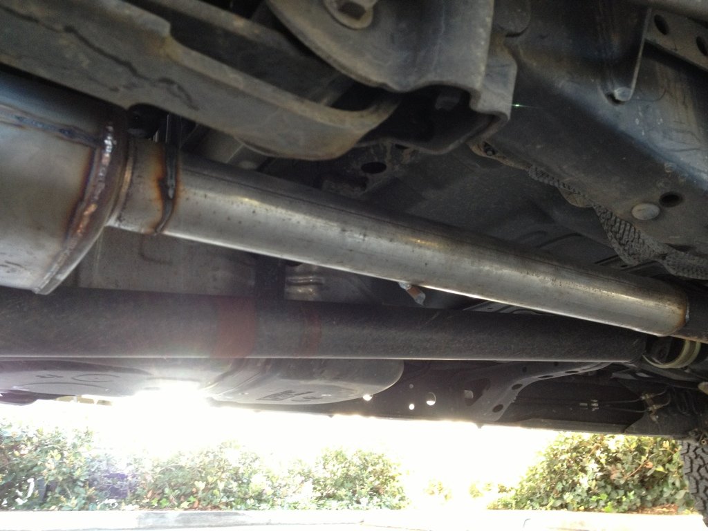

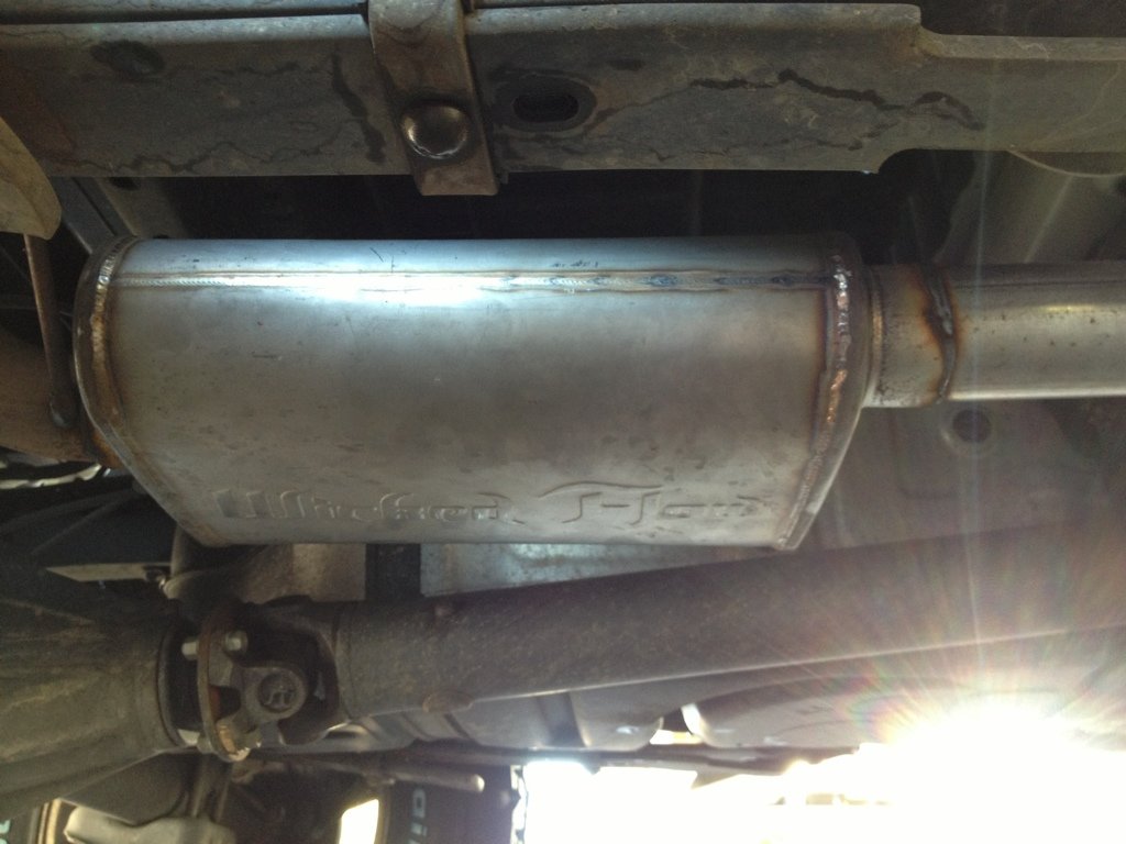

    I see you haven't gotten any feedback on this and dont know if you have decided on a muffler yet.
    I just got a wicked flow muffler off craigslist for $40 and had it installed. I had them hack off the stock muffler and use the stock piping and put a tip on the end.
    Sound is amazing. It is not loud or obnoxious, but it does have a nice rumble when you get on it. There are tons of threads on this exhaust but unfortunately nothing does it justice until you actually put it on your truck!
    On the freeway it is virtually silent and is only noticeable when it downshifts.
    Ill try and get a decent video of mine but here is the best and most similar to mine.
    http://youtu.be/Eug4gLE7jwc
    Hope this helps and sorry for the tire shine. lol

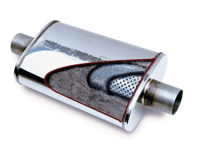

    Personally, I would stay away from Wicked Flow mufflers. I am in the exhaust business and inquired about Wicked Flow mufflers with my distributor and he told me he no longer sells them because of all the problems his customers were having. These mufflers are basically a knock-off of Magnaflow mufflers. My distributor even had a Magnaflow and Wicked Flow cut open so i could see the mufflers and internals side by side. They looked identical, with the exception of one thing, the stainless mesh. In the picture of a Magnaflow below, you can see there is a perforated core, stainless steel mesh surrounding it, and fiberglass packing beyond that to muffle the sound. Wicked Flow does not use stainless mesh so the mesh quickly rusts and rots out resulting in the tone of the exhaust changing as more of the mesh breaks down and exits through the exhaust. Just my $0.02. Plenty of members have Wicked Flow mufflers and are happy with them, but a Wicked Flow didn't make its way onto my truck.
