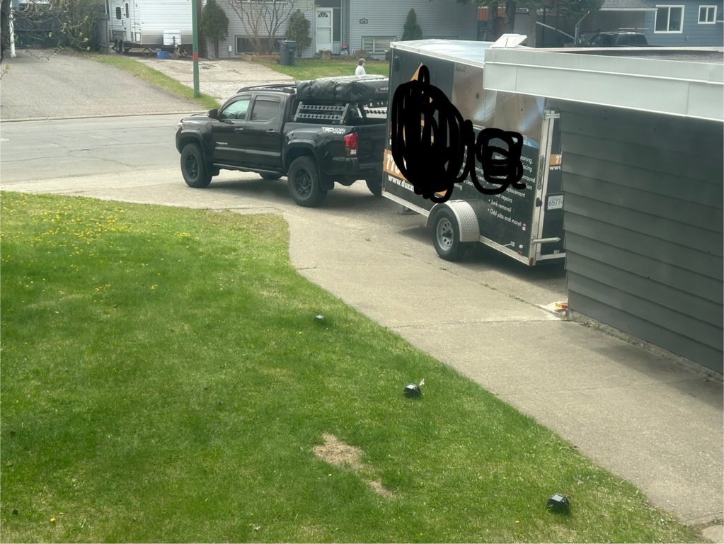

    Man if your brakes on that 2500# trailer are working properly, you should have absolutely zero issues with stock brakes on your taco.
    Did you buy that camper new? Did you "burn in" the brakes? Like get them so hot that they start smoking?
    I tow a 6x12x7 enclosed and my Prodigy P2 is set up at like 50% capacity. I can stop my truck and trailer very quick if i needed to. My truck is not stock. 33's, 2" lift, and 550# constant weight. If i go close to 100% braking on my trailer, it will slow down my truck and trailer no problem.
    This was my first trailer with brakes and the place where i bought it from never told me to "burn in" the brakes. When i first got my trailer, i thought the brakes weren't working. I called them and explained the situation, they said you gotta get the brakes very hot in order to "break them in". I wish they told me that when I picked up the trailer cuz I could've been a danger on the road.
    So i took the trailer downhill, used only trailer brakes and got them smoking hot. Holy man they worked really good after.

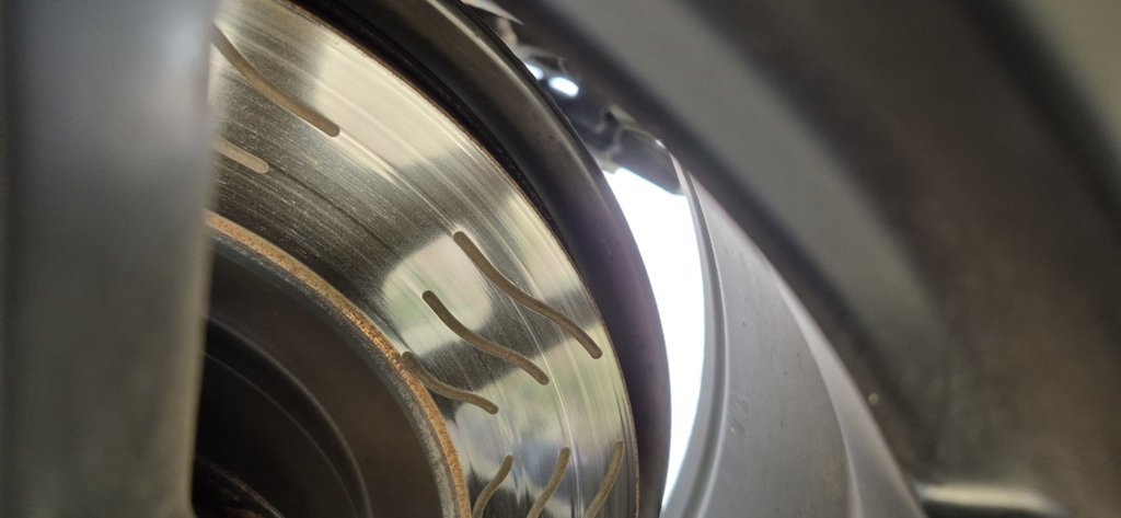

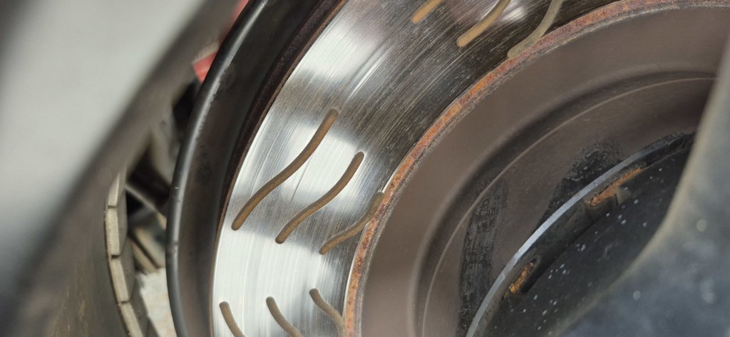

    There is 2 grooves wearing into the rotors. It is on both and on both sides. I noticed it in April when I did my winter tires swap. Now, I wouldn't consider myself hard on my brake. The originals, I changed at 110,000kms and it wasn't really needed yet. I just knew I would be towing and felt new brakes would be better than worn brakes.

    that's going to be from the horizontal orientation of the slots.
    a slot design like this will have a lot better wear characteristics, with the added benefit of the pad scraping that you upgraded to slotted rotors for to begin with.
    the whole idea with slotted rotors is to wipe the brake pads during application to ensure that there's always a clean/fresh layer of pad material to perform the braking.
    they generally result in a lot more dust, and lower pad life, because they're cutting into the pads, but will also offer a more consistent brake response.
