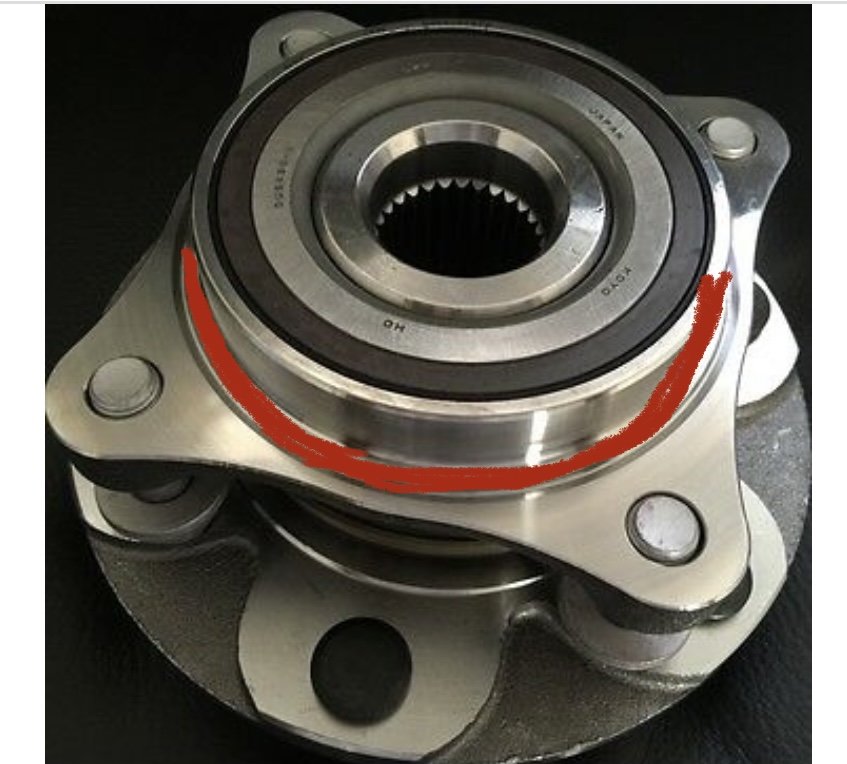

    Another thing that should be noted is that the parts that I ordered from ebay did not come with new rubber seals, at first I was going to reuse the old ones but the friend I was doing the job with had a pair of new ones from a previous job. Almost missed it though, had to take off one of the hubs that we already put in because we didn’t realize that there was a seal on the old one.

    I’ve marked in red where the seal should be.
