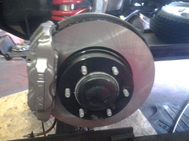

    Wheelers offroad has a nice set of ss brake hoses. Tundra brakes is a nice upgrade. I have them on my taco and my 4runner. Pictured is the size difference from the oe tacoma compared to the tundra.

    I purchased ss brake hoses from Wheelers Offroad so no modification was needed. Their hoses come with the correct banjo bolts for the tundra calibers. It's a direct bolt on, I did it on my lunch break here at work. I just had to trim the backing plates a little to clear the calibers. Big difference in the stopping power. My main reason for this upgrade is I tow a 17ft. Fiberglass camper, and they look nice looking thru my SCS F5 wheels. These calibers clear the stock 16" TRD alloys also, but as previously mentioned not 15's.

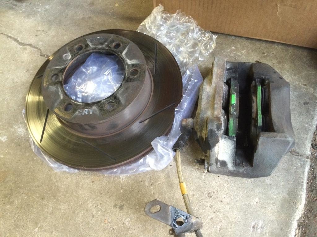

    I have the entire stock front brake assembly from my 02 6 lug off the truck and for sale.
    Calipers, pads and rotors along with steel lines.
    Let me know as I can separate the kit and sell just the calipers.
    You pay shipping.

    Fully functional, could use a good cleaning.

    Calipers have 200k but show no sign of issues and worked perfectly.
    The rotors has 40k
    Pads have 4k.
    Only reason I Pulled them off the truck was my upgrade to tundra brakes.
    I will let the entire lot of stuff go cheap as its just sitting in the garage boxed ready to move.
