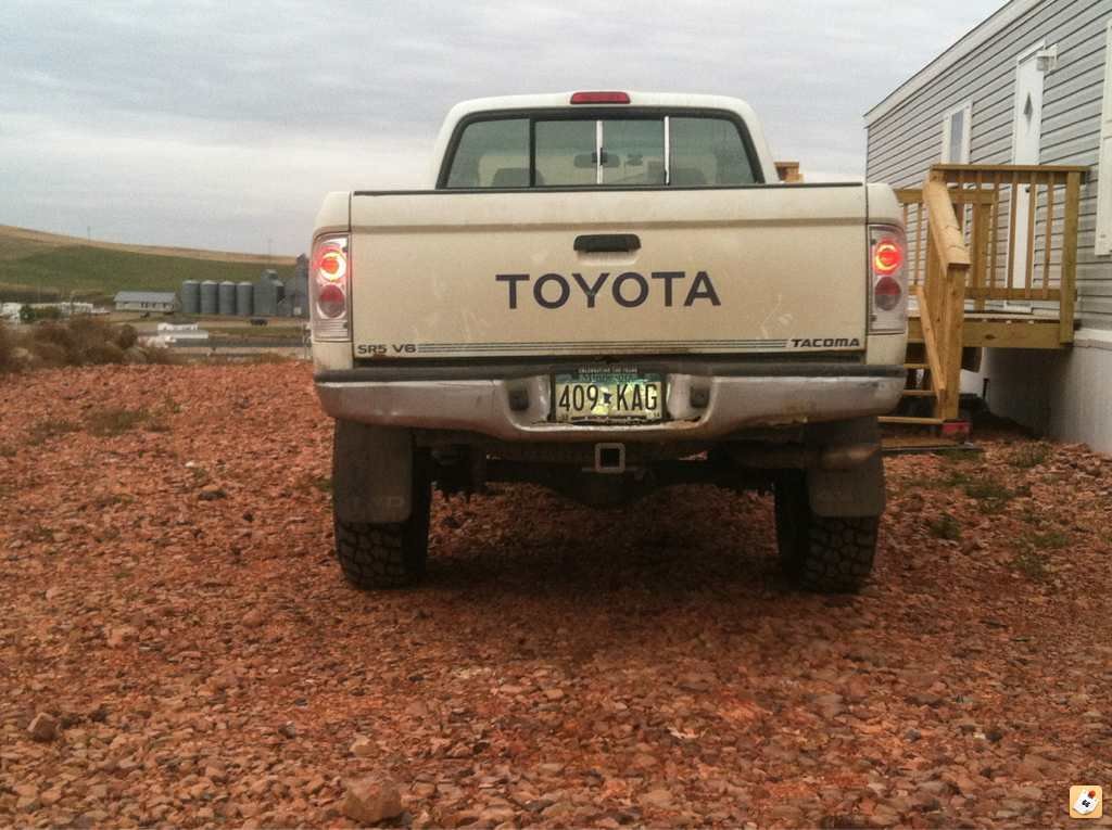

    I have aal springs in already I'm sure there not as sprung as when I put them on but right now my trucks sitting pretty levelyja9a9e3_0a4b5474bd23bb9845a61565cfafb852f3816a23.jpg7esegege_776cd89cc647ca8462a7aacbcdb50d2b9542608d.jpghynu9ede_ecd55d2c88cb59a0f542234de7c6abf2296bca94.jpg

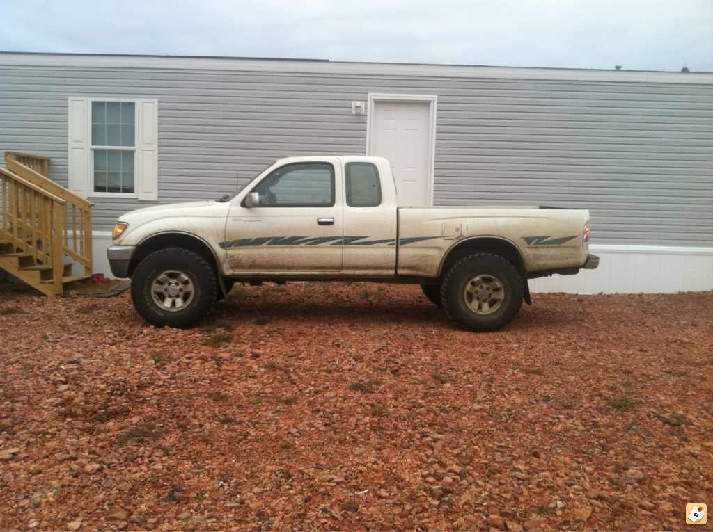

    You can see which side has the broken leaf on it... Little sag to that side

    yea you don't want to drive with a broken leaf fo too long.
    just get the Dakars or wheelers 5 pack to start out with. Add the aal later. id use the AAL thats made for the packs not a generic one.

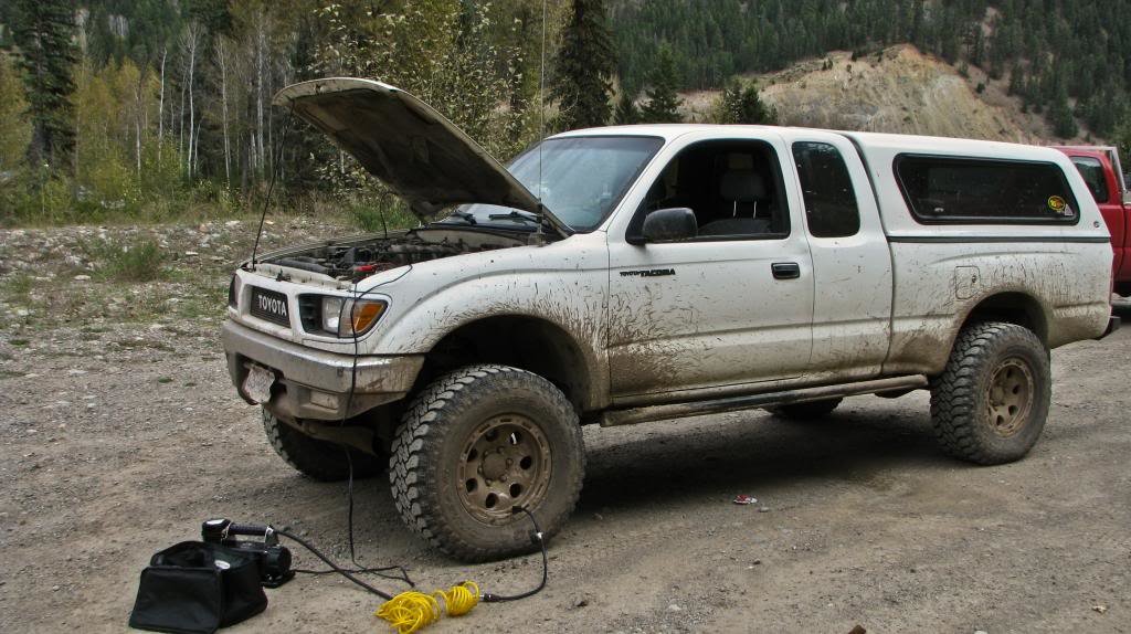

    I bought the All Pro Standard 3" Leaf springs and i had to relocate both front/rear hangers.
    This is them with about 200lbs of gear inc the canopy. Little bit of sag

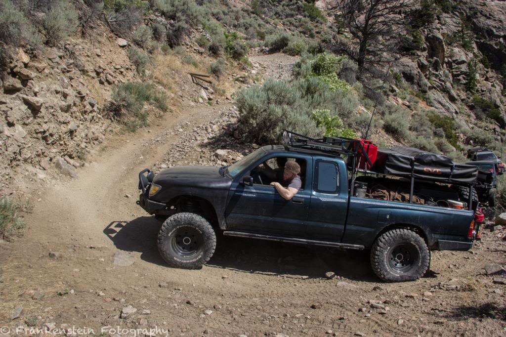

    mine is like this
    There are tons of RTTs out there now. i went with CVT. Great tent and price and fantastic customer service.
    rear bumper was custom ordered with swingout. I added the jerry can holder and table. i also had to fix the latch. It was Tims first swingout bumper and he told me it was a PITA and probably wouldn't do another one. Was expensive too.

    I don't have a sun roof. It's about 1" from the roof or so.
    If your gonna have a roof rack like that..forget using the sunroof haha
