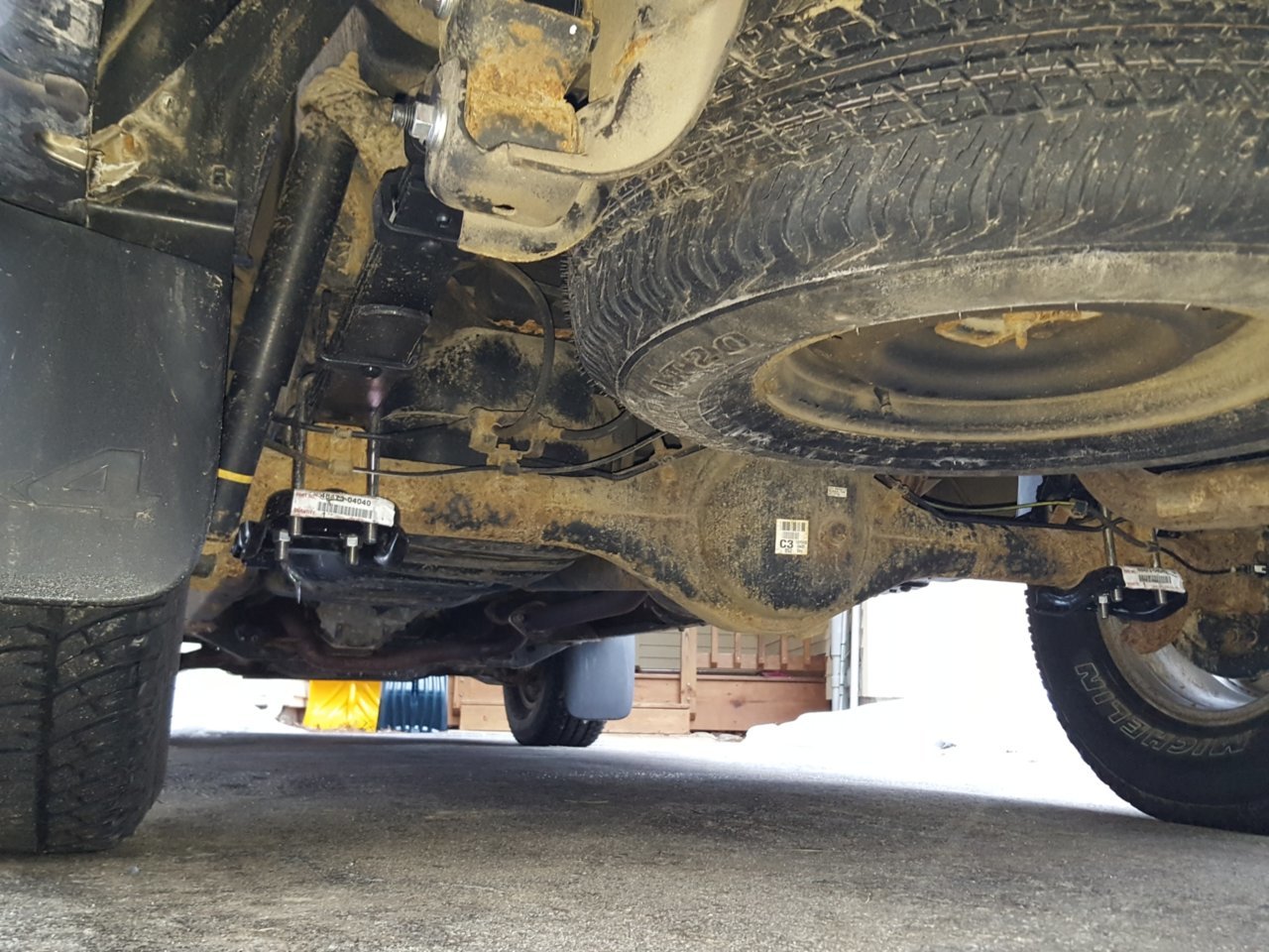

    Yeah, mine was. I'd been putting off having all the recalls done, but they just did these last Friday...

    Damn, look at that rust...
