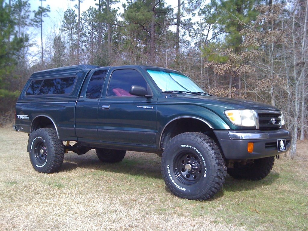

    I went with a set of Wheeler's 1.5" 5 leafs. I run a fiberglass Century humpback style shell and ended up having to get a set of 3/4" shackles from ToyTech to level it out. It's been about 4 years now and it still sits the same though. If I were to do it again I'd do the 8 leaf set and be done with it. There'd be that option of hauling something and still ride well.
    Right after the install and it still sits the same today.
