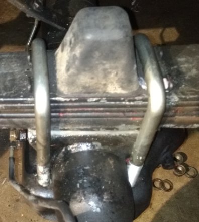

    The Toytec BOSS Suspension System. With the OME leaf spring packs and SPC UCAs. I also had them include the longer rear brake line, which is definitely needed. The lift was pretty straight forward to install. I had some rust issues and ended up needing new shackels which I sourced at a local spring shop. I had a vibration issue that I chased for awhile and added rear axle shims trying to fix that. I don't know if that was necessary, it didn't help and it turned out to be a bad U-joint.

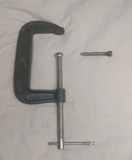

    The videos I watched were all on 2nd gens where the AAL was added on the truck. I ended up pulling the springs and adding the AAL off the truck. It was easier for me to handle (e.g. wrestle) by laying the springs flat on the garage floor. After botching up the threads on one of the spring bolts, I used it to make a guide pin that I could run through the springs while compressing them with the c-clamp in the picture. I started using two c-clamps in the beginning and quickly realized the 2nd clamp was getting in the way and that I could do it using only one clamp. Once I had the springs aligned with the guide pin, and the springs compressed, then pulled out the pin and inserted the bolt and tightened up without issue. Initially, I started using a screwdriver as the guide pin in the beginning. The screwdriver wasn't thick enough to get the springs perfectly aligned so the bolt could be inserted without scraping on the spring and botching the threads. I'm glad that I had 4 bolts. Two came with the AAL and two came with the shim. So I wasted one bolt that I use to make the guide pin.
