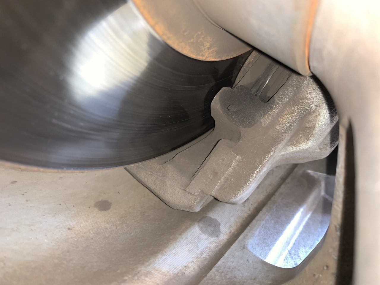

    Can I gather any useful info about my brake condition from these photos? I am on OEM factory brakes, now at 72K and wondering if it's time to get them fully serviced. Last couple times at the shop (60K) the guys said they were fine. I noticed a clip style spring come loose off the front brake, and put it back in place with a pair of needle nose pliers.
    I wedged my iphone inside the front passenger wheel and took these pics from the top and bottom facing back towards the caliper.
    Wondering if anyone has any thoughts on pad wear and such. Thank you, kindly.

    I see some pad there and it looks like some weeping of brake fluid ....are you having any issues? If you can I would recommend a brake inspection - pull the pads ect. Are you doing the work yourself?

    I sprayed a small amount of brake cleaner in there an hour before taking the photo. I should have mentioned that sorry. Not doing it myself, I’ll either go to dealership or go to my lift and overall mechanic guy’s shop depending on cost and time. Dealership is expensive, but shop guy is a far drive, really busy and backed up sometimes.

    Factory pads wouldn’t hurt at that mileage. That was about the time I replaced the pads on MY13.

    Thanks. Also no issues, they just kind of suck. Soft feel and a bit slow to grab on hard stops. Rears are noisy in reverse usually. Figured 75k was about right for a brake job.

    Went in for the 3 month later inspection. odometer 76.5K Walked out with fluid flush, new front pads, turned rotors and cleaned out drums. Glad I held on and got this done at the right time, and thanks again for the tips.

    PLENTY of pad life left there. Maybe a fresh flush of brake fluid but everything looks good there IMO.

    Suggest running your finger tip across the rotor surface from inside to outer edge to feel for grooves. If it's smooth, I would just do a pad swap and a fluid flush.
    I do all of my own brake work, because it really is very simple and easy to do. For brake flushes, recommend the Motive bleeder system. You can pick up the system with the correct adapter plate for <$100, which is probably less than what you would pay a mechanic in labor for one brake job.
