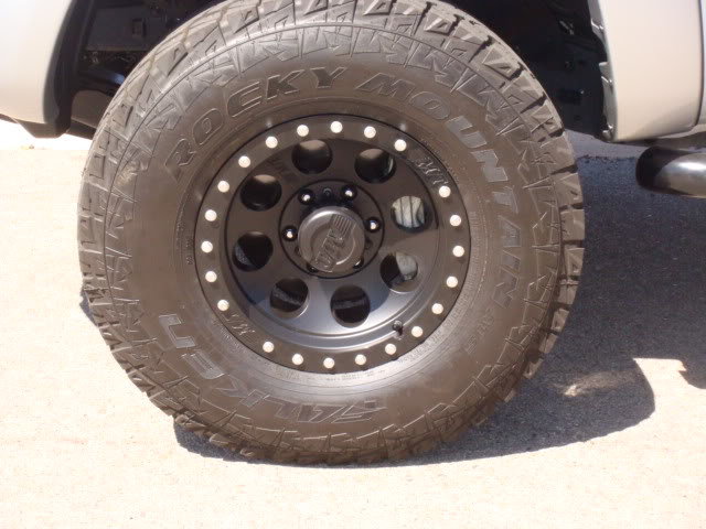

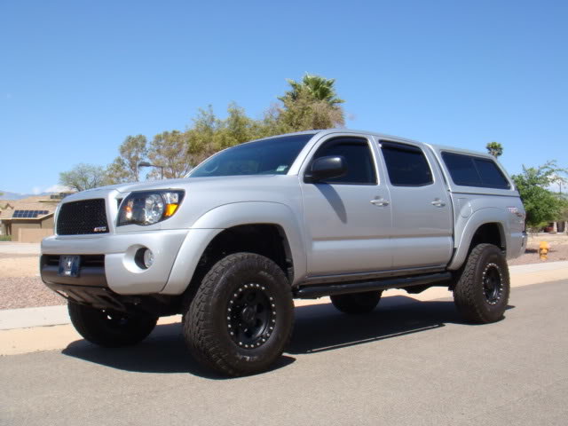

    I am partial to #1 for obvious reasons.....
    DSC03868_2b9e13b9ef607112e8f07d315ebd37e17fd45e71.jpg">
    DSC03869_55df497b2a0e4ecb8e8a6ea869c1a6ebe85fe806.jpg">

    I voted for number 1 for a few reasons.
    1. I like the bead lock look.
    2. I want this wheel myself.
    3. The holes are bigger, which I feel looks better than the pro comps.
    My second choice would be number 2 (pro comps), and actually would come down to pricing.

    I can tell you the mickey thompson classic ii's with 4" backspacing will not clear the brake caliper on a second gen taco. You have to get the 3.625" backspacing. Ask me how I know.
