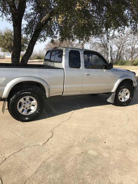

    I just want my truck to look more agressive. This is my Ride to work everyday so it's a highway mileage and my bugget is about 2,000
    This is my ride

    just go with a 265/75r16 all terrain, I think those wheels might be 15s tho so 265/75r15 thats about a 31.5 inch tire. Then you don't have to trim much, don't lose too much mpg, and it'll look more aggressive. Maybe also paint the wheels a darker color? light colored trucks go great with dark colored wheels. What lift do you want?

    Cheap parts = weak results. But you might think it looks stellar for photo shoots in front of abandoned warehouses.......
    It's a nice looking truck like it is. And for your description of how you use it, it's good as it sits.
    But it's your truck, your choice.

    Your ride is going to suffer from large wheels and low profile tires. I'd just keep your wheels and get some awesome tires in 265/75/15 and decent shocks (bilstein 5100's) with an add a leaf in the back. You might end up somewhere around $2k with that.
