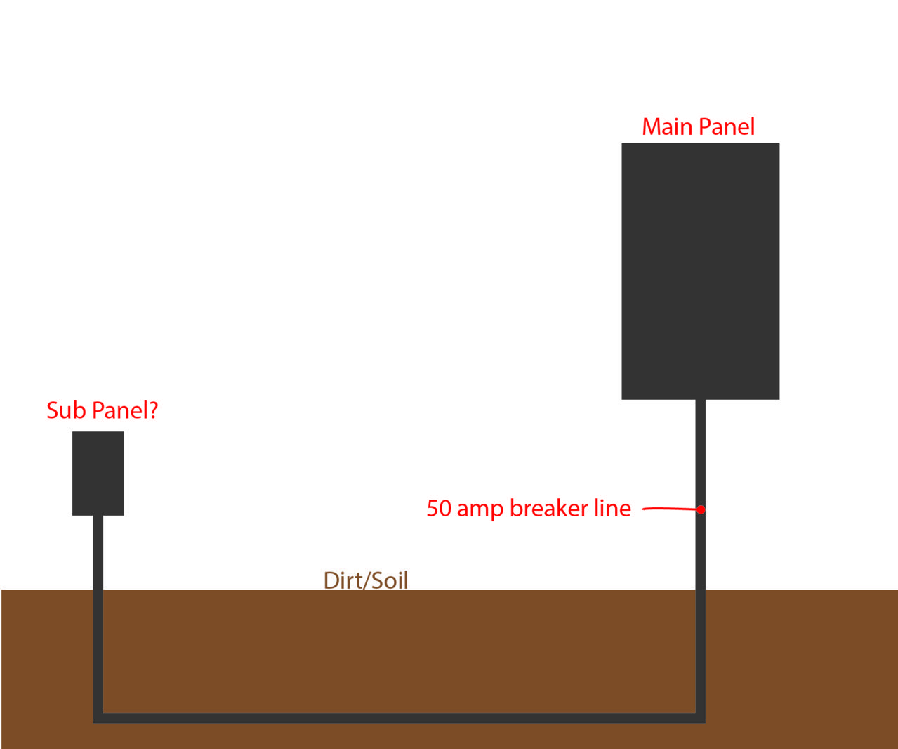

    I currently have a 50amp breaker that used to lead to a backyard spa that no longer exists. However the conduit is still protruding out of the ground with the wires (10g?) still capped and ready to be used again.
    What could I do or need to create a sub panel of some sort for outdoor resources like lighting or power tools?
    I am very handy and can tackle the basics of installation. Would like some guidance on the parts I would need or if there is any other suggestion of how to use that 50 amp breaker.

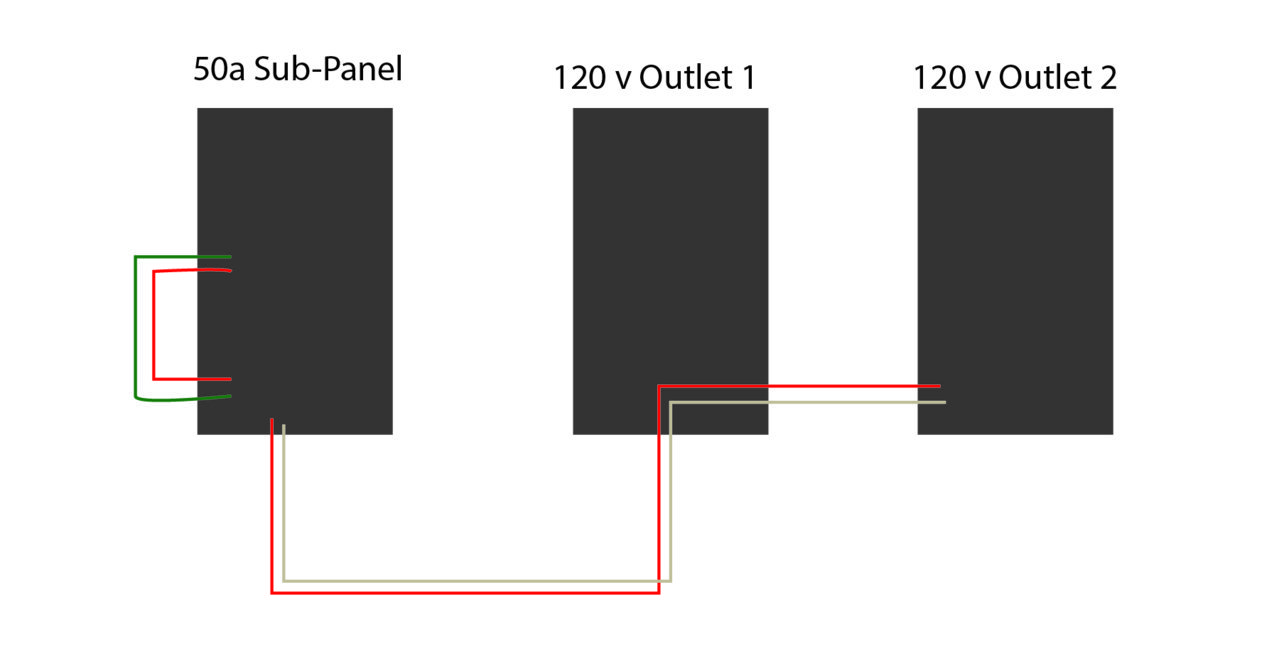

    Here's my diagram as well.

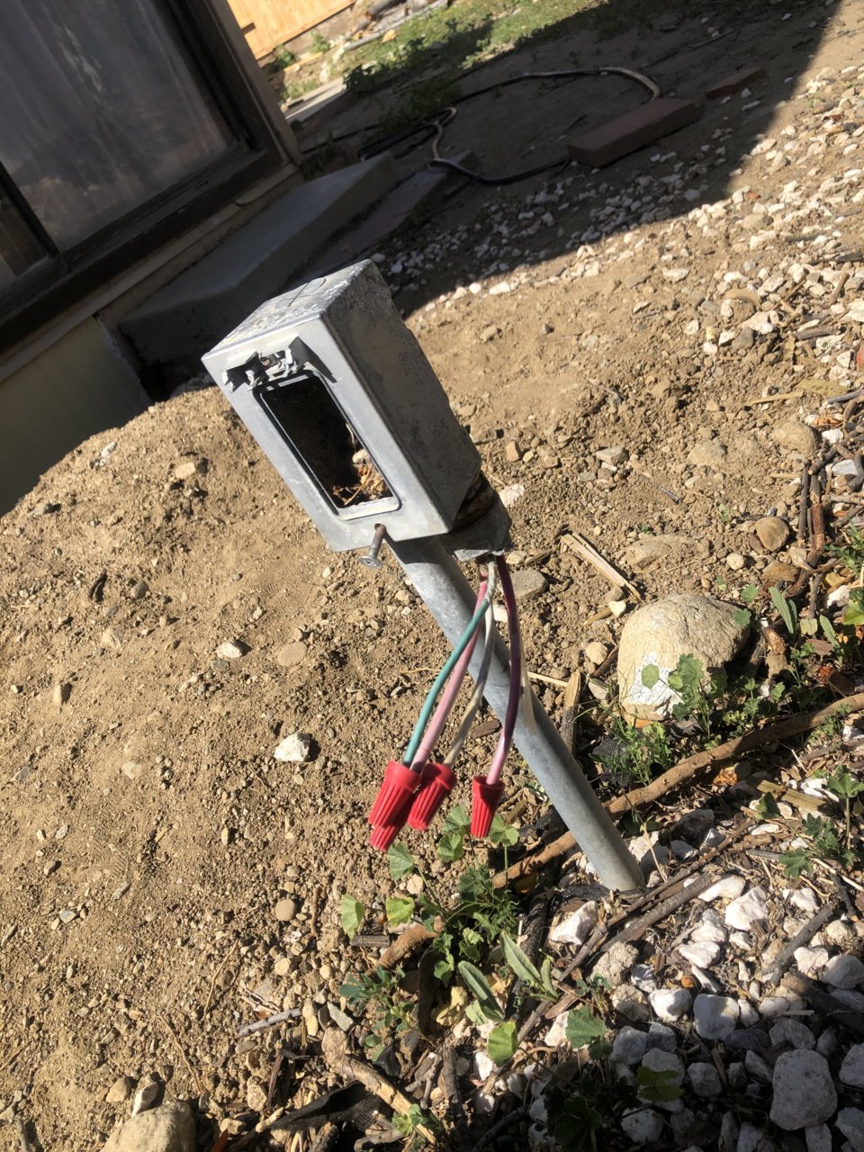

    As for the wires, wife is getting a picture for me right now as I am not currently home, standby.

    Heres what the conduit currently has.

    That's two hots, neutral and a ground. I'm curious why they are sticking out that way. Unless that's what used to be the run for the jacuzzi or whatever it was. Use that white and one of the reds. You can daisy chain two outlets there no problem. And land the red wire into a single pole breaker.
    As far as the box goes you can make a run to home depot and buy the weather box you need. Two outlets and that's it. Just make sure you can adentify the red you want to use and that this white wire is on the ground bus bar.

    Feed it off the first outlet. Once you tap red to gold screw and white to silver screw you will have the other gold and silver open. Feed the second outlet off that.

    you can do a couple of things with what you have out there.
    Quick solution- if you only want one 120v 20amp circuit - buy a new single phase 20 amp breaker for the main panel and wire up a 20amp GFCI outlet and replace the cover on the bell box.
    If you want two 120v 20amp circuits to add a bell box to the backside of the existing bell box, buy two 20 amp breakers wire up two 20amp GFCI outlets with covers.
    To correctly install a subpanel it's going to take some time and money.
