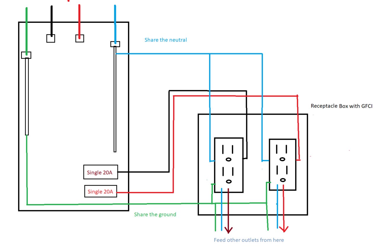

    I'll shoot some images tonight. Draw out another diagram with a bit more detail and maybe you guys can get me to decided on something 100%.

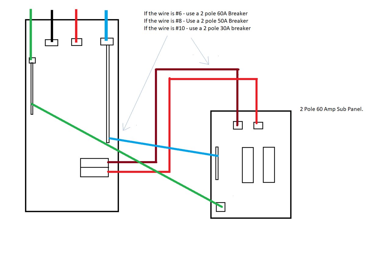

    Option #1 - Use a 2 pole breaker in the main panel. If your only going to be installing outlets and / or lights, a 2 pole 60 is overkill. A 2 pole 40 or 50 will work just fine. Save yourself a little money here.
    Use 2 individual breakers in the sub panel. GFCI breakers are more reliable and probably more expensive too. If using standard breakers, a GFCI receptacle should be used.
    Option 2 - use 2 individual single pole 20 amp breakers. If the wire is to big to attach to the GFCI's, you can use shorter pieces of #12 wire.

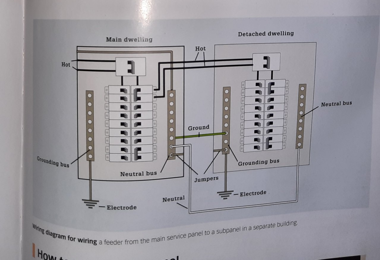

    Where did you get that quote? Not 100% sure - but I think that fails the bonding / grounding requirements?

    Maybe outdated but its legit

    Grounding and bonding changed a lot this year. If I'm not mistaken, your Main Panel should show a ground from the outside service. And, the Sub Panel ground should not go to the neutral bar.

    I've been working maintenance for the past 15 years. Haven't done an "inspected" job since then. I do still take my refresher exams to maintain my license. And there were lots of changes when I took the exam. Mostly grounding and bonding. Pretty sure that the ground has been isolated from all load centers after the first panel for a couple of years now. And a ground is required in the service past the first panel. But I will review as you suggested.
