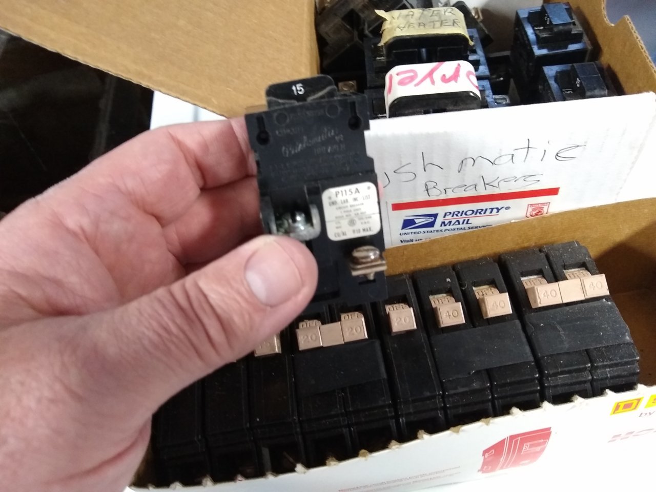

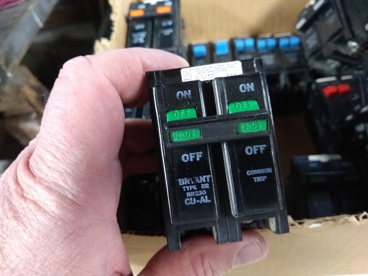

    @LivinOnEdge No disrespect to you but if I was tasked to do this job first thing I would say is meter/panel combo needs replaced. If homeowner balked I would walk. I have replaced many, Cutler Hammer, ITE, Bryant, GE, etc panels because they are just junk. Having changed many of these services I have surplus breakers, why I keep them who knows they just collect dust. I even have a couple Pushomatic breakers! FYI Bryant breakers will fit your panel.
