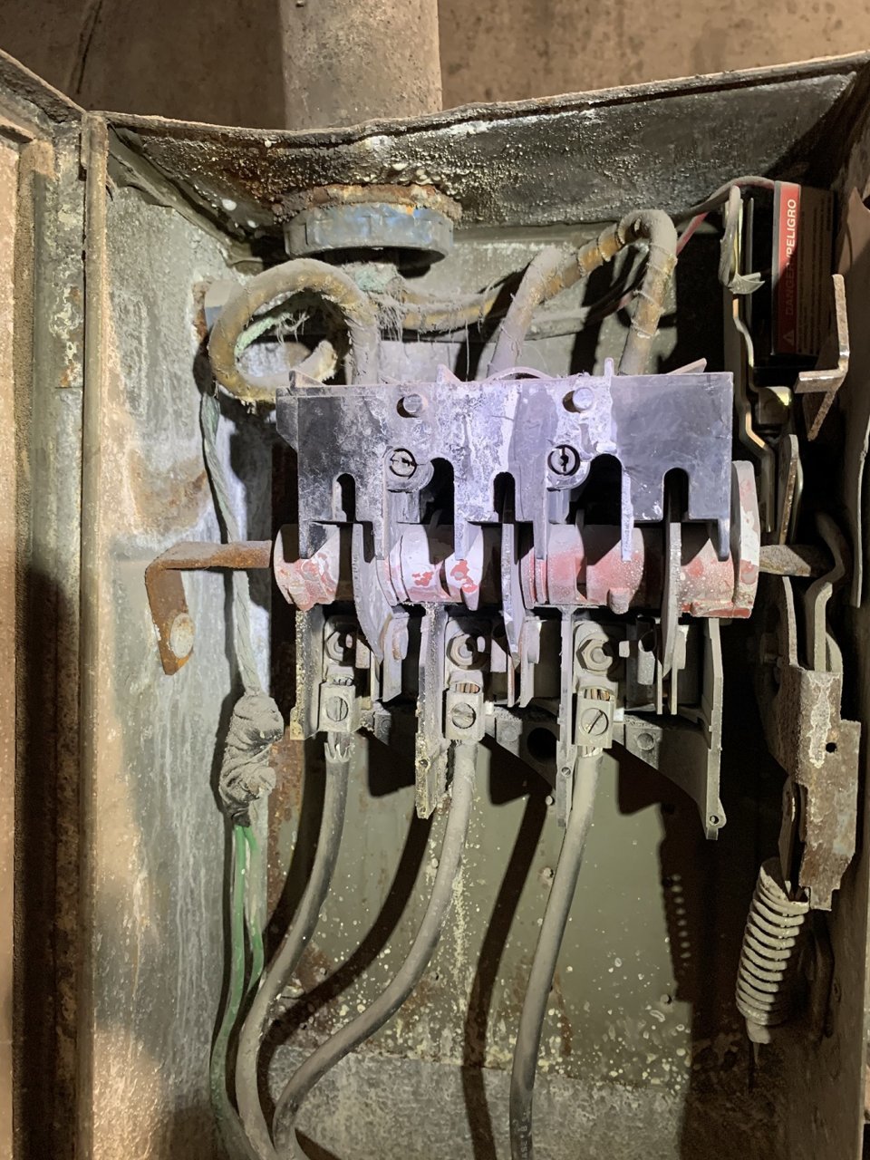

    Lead solder joints started way before the 70's. For all i know, it goes back to the invention of electricity? The Industrial plant I work in was built in the early 50's. Is still being used today. And still has some of the original paper coated (lead solder) conductors (still being used for lighting and motor circuits).
    Here is a motor disconnect servicing a 75 HP 480V motor. The Feeder Circuit (Line Side of the disconnect) is paper coated.
    tirediron and MoneyMan55[QUOTED] like this.

    @MoneyMan55
    Here's the other end of the spectrum. The joys of my world.
    MoneyMan55 and LivinOnEdge[OP] like this.
