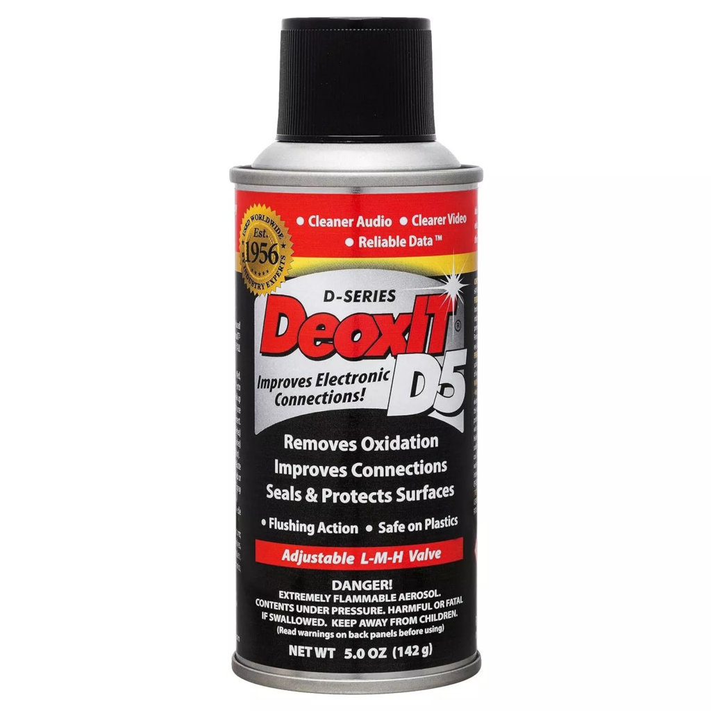

    I have a 98 and autozone had a lifetime replacement one for my driver side...
    dura last......
    very expensive like $110~$120
    If you've got the time ....WTB in the classifieds
    be warned these contacts here and column headlight switch....will go bad eventually
    just a matter of time
